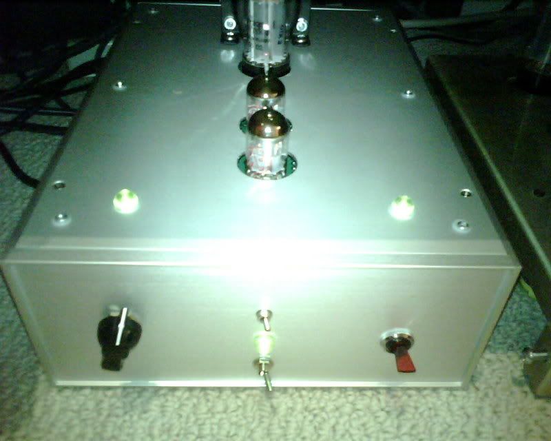

I just finished my Chime yesterday, only had a couple glitches. The main one that I didn't know the secondary transformer T400 had sides. All the pictures I saw of chime innards showed the label of the transformer facing the front so I went with that. Little did I know there was a clear plastic labelling of 1,2,3,4... on the face of it! No problem, just blew a few fuses tracking that one down. The other was the select knob. For the jumpers on the volume control the manual shows installation while looking at the board from one direction, but the jumper listed for the selection knob was from looking at the other side of the board. No biggie. I did a couple small changes, put in the fast/slow rolloff switch as mentioned above, and put the heater LED on the front panel. Everything is working great so far. Now I just wish there was some kind of downsampling device I could install inside so I could run my dvd player through the chime.
Also, I was shocked how good the sound was through usb. I'm using a half-decent creative labs external device which I thought sounded okay, but this blows it away!
Here's a really bad pic taken with my camera phone:

Thanks for sharing your experiences and the picture.  I'll add a "heads up"
section to the write up I did mentioning your two gotchas and any others
which come up.
