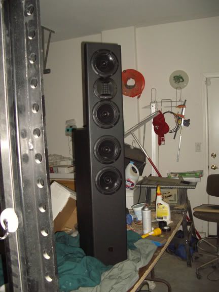

I just wanted to share these photos with you guys.  Long story but I only did one speaker so far and I'm now in the process of doing the other one.  I posted these shots on the GR Research circle two days ago.
They are the OB-5's.
The beautiful garage scene is extra of course.
Thanks
Bob in St. Louis

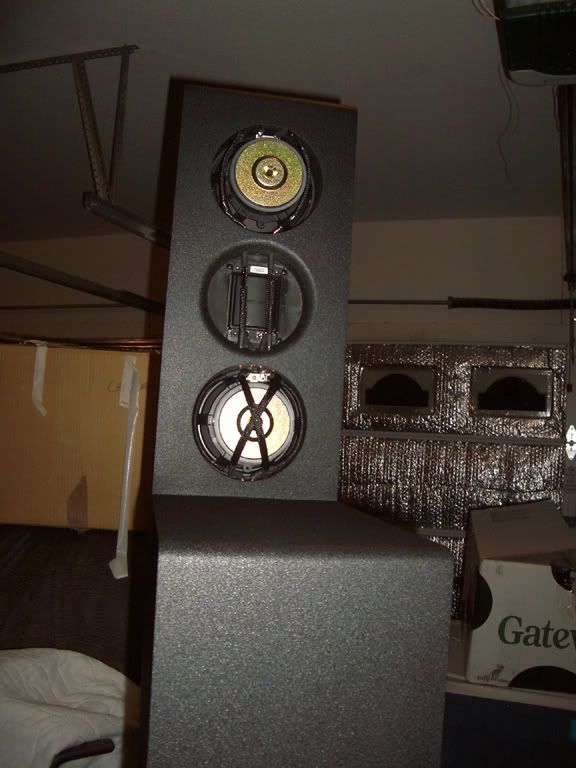

Very Nice!
I love the hidden wiring.
What kind of coating/paint is that?
Bob

Thanks.  Textured bedliner for pick-up trucks.  7.99 a can

 I must say the finish looks great in your pictures . Shouldn't chip off either while moving . I just wonder why some cabinet manufactures charge $1500+ for cabinets . MDF is cheap per sheet . You did it for $7.99 a can . Well done !!

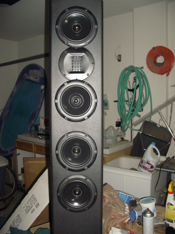

Thanks for the pictures.  I really love the contrast between the greyish-pewter baffles and the black drivers.  When you move your speakers out of the garage and into your room, could you post a couple more pics?

 The truck bed liner is a great idea and there are a few tricks for the kit builders that plan on going this route. The key is to have your edges as smooth as possible to start with and DO NOT sand the smooth surfaces of MDF. You will only make more work for yourself in the long run.
 Go over all the smooth surfaces with a rag damped with alcohol (about $2 a quart) and let dry.
 Now on to the bed liner.
BE SURE TO DO THIS IN A WELL VENTALATED AREA AWAY FROM ANY FLAMES OR SPARKS.
The first step here is to do a quick, medium coat over all the cut and machined edges. Let this dry thoroughly and then sand. I use a 150 grit paper here. This first coat seals the cut and/or machined edges of MDF nicely. If you still see some fibers or "hairs" after sanding, apply another coat and sand once dry.
 Now you are ready to do a complete coat of the bed liner. If done right, only one medium, even coat is needed.
 This finish can actually look very nice and provide a rugged, durable finish. It also helps to dampen the cabinet.

I have used truck bed liner numerous times as my finish (cause I suck at anything universally accepted as good!), and Bill's tips are excellent.
My only addition would be to be careful about the distance from the can to the item - too far away and you create a sandy finish, too close, and you run the risk of "runs" as more likely.
Great work by the way, on those OB speakers!

Funny you would mention that.  I must have been a little too far away then on the back side.  It did create a sandy feel to it.  I just sanded it down and re-applied another coat and it came out fine.
I'll get the finished pics up soon.  Can't wait to break these babies in!
