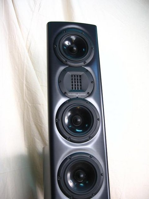

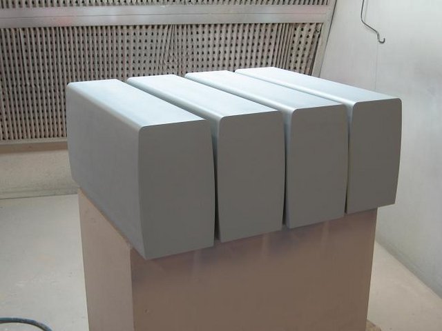

We've finally found the time to finalize the design of the bases, they definitely add to the overall look. They are finished in a charcoal grey metallic pearl. I've tried to highlight the curves that we've incorporated. Not only are the sides curved, but the baffle front as well. I'll post some better pics shortly.  :thumb:
Outstanding, very nice.
You said finished in a charcoal grey metallic pearl.  Is that strictly a paint or a finish/stain on veneer?

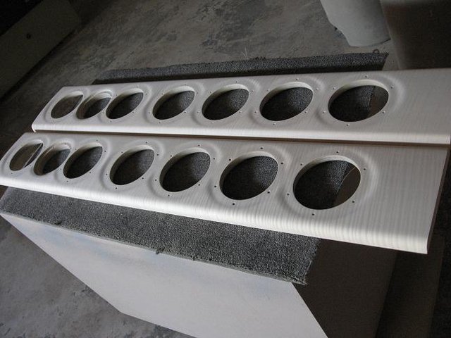

Mother nature is responsible for the vast majority of it.  :lol:  These speakers are in veneer. Curly maple veneer on the enclosures, and tiger sycamore for the front baffle. This dark charcoal color is one I developed for a client a number of years ago for a large media center, that I really like. It's a 4 step process. At various angles and lighting conditions it sometimes looks like an opaque dark charcoal, at others it's a translucent charcoal. It's a very sleek, modern look, that blends really well with other decor.
The reason we use the two different woods is that it's hard to find maple with that kind of "fiddleback/tiger" grain in pieces wide enough to do the baffle in a single piece. The sycamore comes oftentimes in pieces averaging 11" in width. So I can do mirror imaged baffles. It's very similar in color and grain to maple. And the figuring is real vivid and from throughout the whole piece of veneer. Maple often times doesn't have the figure running all the way thoughout the piece. The veneer on the baffles is raw veneer, on the enclosures it's paperbacked.

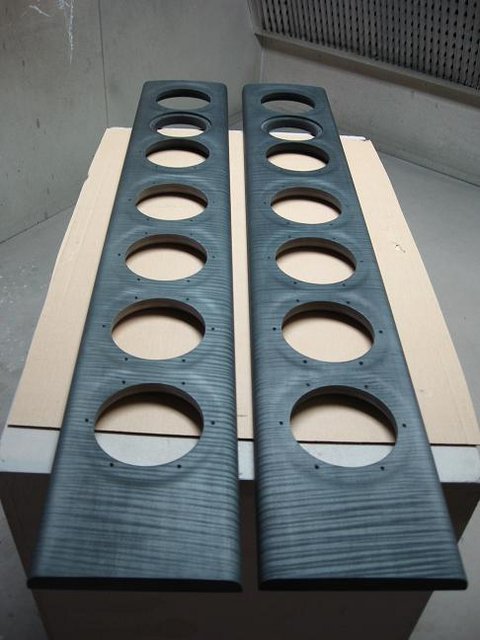

Prior to staining:
After staining. There are three more steps to achieve the final color. To get the warm grey color, we need to get the bluish/purple tone out of the veneer that is the result of black analine dye.
This is where I first developed the color:

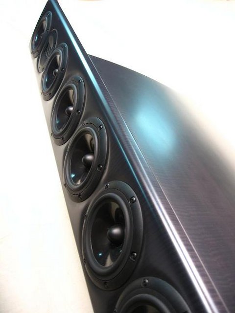

Alright, I'm not afraid to admit ... I'm in love with your baffles!  That smooth recessed look is just killer, any chance you could show us how you did that?  All I can of is cut the driver holes and use a cove raised panel bit like this, and lots of hand sanding
And how did you get the veneer so flush against all those curves in the driver recessing?  I assume it would be impossible with raw wood veneer, is paperbacked a must?

The method we use to achieve that look is something that is the result of many years of striving to achieve unique details in craft manship, as such, the techniques I've developed over the years for things such as this are ones that I haven't inherited from anyone else, but developed on my own, and, as such, are things I'd prefer to keep proprietary.  :P   :wink:

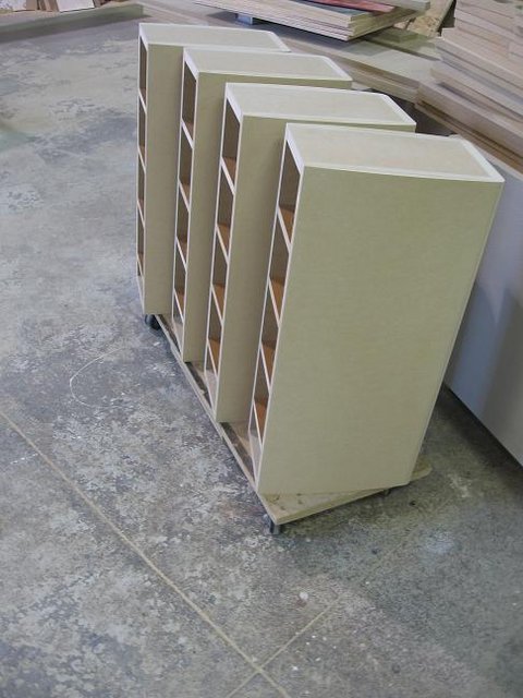

For those interested in DIY, these are pics of our OB 7 flat pack kits.
These include all the raw MDF pieces you need to build your own OB 7's. These flat packs will be CNC machined and pre fit. All you need is glue and clamps. Bases are included. They include 1/4-20 threaded inserts for spiked feet.
Front baffles are triple 3/8" laminated MDF, and are 1 3/16" thick. These are much stiffer than solid 1" or 1 1/8" MDF. All driver holes are cutout, and the backs of the driver holes and side baffle edges rounded over.
