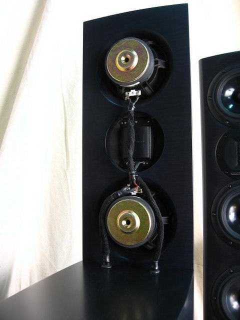

Can we get a shot of the back of the OB-5's wired up to see how you manage the wire's appearance?

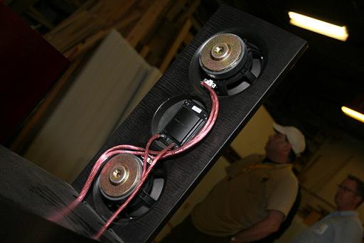

This is how I wired up my pair of OB 5's. I can wire them up differently if you prefer. I kinda like the hot rod look, so I did mine up like this.   :green:

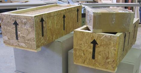

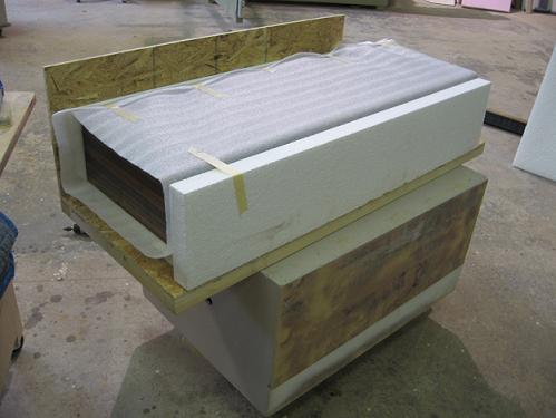

Also, I saw in previous post you were charging for the foam lined crates... what is cost there?
Cost for the crates lined in 2" foam and packaging the speakers is $150.00 for the pair.

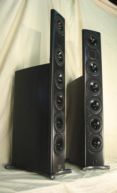

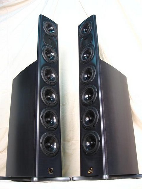

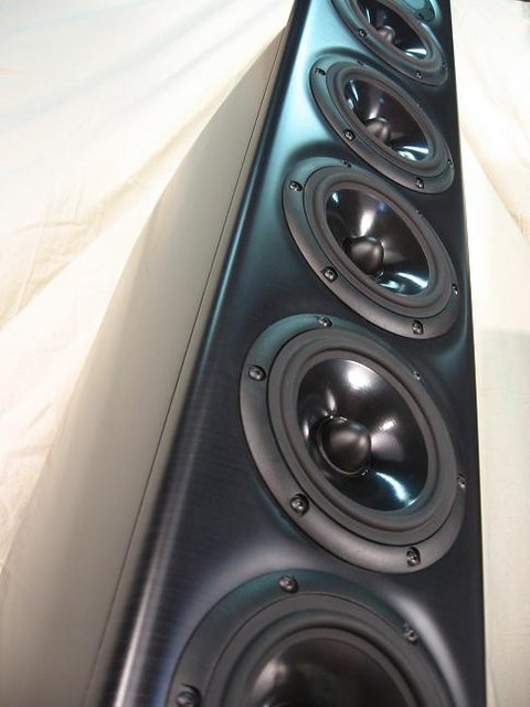

Our first customer OB 7's are finally being assembled, so I thought I would post a few pics. There are a few things we've done differently to this pair of OB's. First is that we've actually angled the bottom of the speaker. The speaker now leans back between 3 and 4 deg. The top is angled down slightly as well. We sent Danny a test enclosure a while back with the new configuration of 4 woofers on the bottom, and tilted it back to see if it would do any harm to the response. It checked out fine. There was a slight change in the network due to the open baffle section being totally free air.
These OB 7's have the optional M-130X (XBL^2) woofers in the lower section.

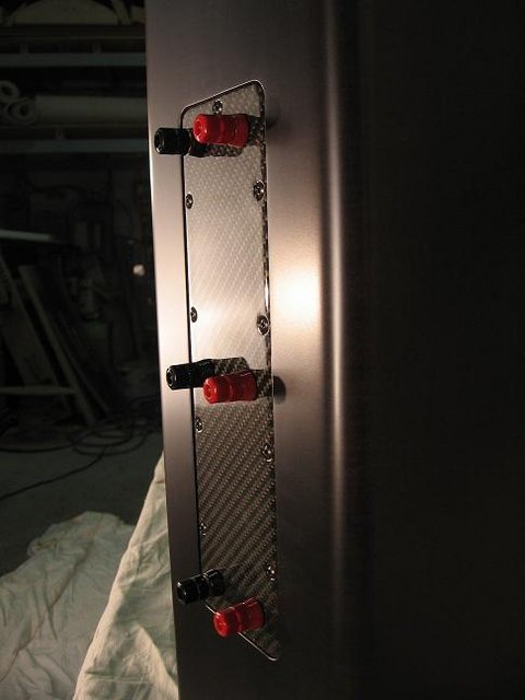

The wiring in this speaker is something that was suggested by Jeff at Sonic Craft. We are using all high purity CCC. It gets more interesting. On the woofers, we are using 14 awg stranded CCC. The + and - leads are twisted together at one twist per inch,(2 conductors) and shrinkwrapped. The mid-woofer have 2 runs (4 conductors)of 18 awg solid CCC. The + and - leads again are twisted at one twist per inch and shrinkwrapped. The tweeter has one run of 18 awg CCC twisted, and one run of 23 awg CCC Silver twisted along with the copper,(4 conductors total) and shrinkwrapped together. All wiring is Teflon coated.
All the caps are Sonicaps, bypassed by Sonicap Platinums. These speakers are set up for external crossovers, that will be Faraday shielded. As such, there are binding posts for the 3 sections (M/T/W). The backplate is done in carbon fiber, and finished in gloss epoxy.
We've finally found the time to finalize the design of the bases, they definitely add to the overall look. They are finished in a charcoal grey metallic pearl. I've tried to highlight the curves that we've incorporated. Not only are the sides curved, but the baffle front as well. I'll post some better pics shortly.  :thumb:

Nice looking Denny well done :thumb: :green:
NealH
  • Posts: 373
Re: New source for enclosures.
« Reply #34 on: 28 Jun 2007, 02:27 am »
My goodness, what superb looking speakers.  They look refined and elegant.
Hank
  • Posts: 1206
« Reply #35 on: 28 Jun 2007, 02:35 am »
Beautiful work, Denny!  I particularly like the large radius relief on the edge of the woof recesses. :thumb:

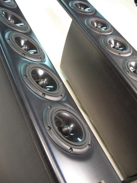

NICE!  :drool: I'm starting on mine soon. Couple questions. Are those custom BG housings? Mine are perfectly round, no coutout for the mids. My kit is a little older though, I'm having it upgraded with new x-over parts and the 130x's. I'm wondering if the tweeters need these housings to react properly with the tweaked x-over (closer spacing to the mids)? I was thinking of doing external x-over also, got any pics?
No. It is the stock (and latest) face plate. The mids overlap onto it to get a closer center to center spacing. Yours will too, and the older face plate will give you the same response.
The GR woofer drivers are a flush mount design with an incorporated gasket. No recess is need for the woofers. The BG face plate is recessed flush with the face of the baffle, and then the woofers partly overlap the BG faceplate. I'll take some closeup pics of the MTM section.
I'll post pics of the crossovers when I complete them. They'll be housed in separate boxes. One for each network, so 6 boxes total.
The customer will be biamping these OB 7's, and will be running a pair of active subwoofers alongside these in stereo. Nice!!
Thanks for all the compliments. I've incorporated a couple of changes since the OB 5's that I think have added up to a really nice aesthetic.  :green:
