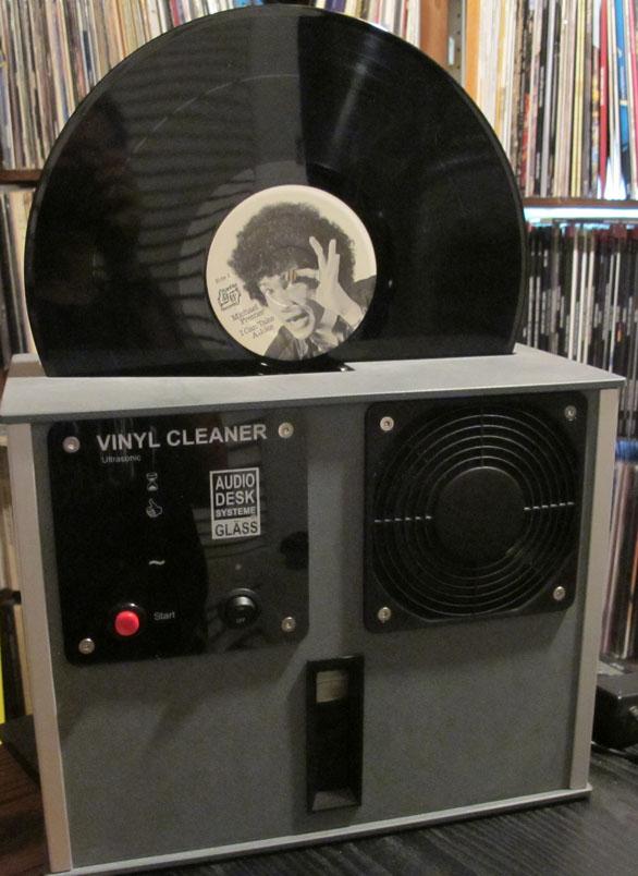

Some more information here: http://www.analogplanet.com/content/worlds-best-record-cleaning-machine
Michael puts in better words than I can.
I saw this in operation at the Capital City Audio Fest show and it truly is completely silent, at least compared to any vacuum machine I've used.  As noted by others, somewhat expensive.  You can buy ultrasonic cleaning machines online for much cheaper, but nothing with a big enough cleaning tray to do a whole LP, at best you could do a half at a time.
