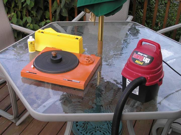

Pumpkinman just lent me his manual, diy VPI clone, and I just bought some 91% Iso Alch, time to try again. Mixing distilled water to alcohol at 3 to 1 ratio, a few drops of detergent, add to a squirt bottle. Take the records outside to the diy spinner, pulled the brushes from the spin-clean, (spinclean worked, but not enough for the really dirty things), spin 'em and vacuum 'em.
« Last Edit: 11 Oct 2010, 09:17 pm by etcarroll »

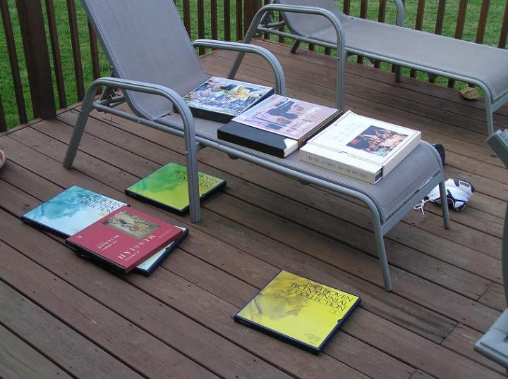

etcarroll
  • Posts: 3217
Re: Okay. . Time to spill your cleaning secrets!
« Reply #139 on: 11 Oct 2010, 09:19 pm »
And here's why, got a ton of old classical, many boxed sets pictured here, plus 3 more boxes of loose albums, all dirty to greater or lesser extent,
