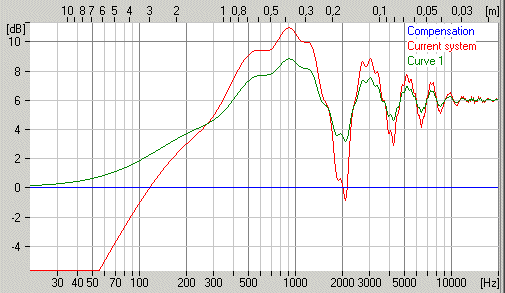

I did a simple simulation in EDGE:
The result for a 15" speaker is - very predictable - a dipole peak at 700 Hz and the usual 6 dB rolloff below. If you equalise the 2dB hump around 700 Hz, you should have a nice flat response down to 250 Hz @-3dB. Floor response will even lower that. (I imply that the silver iris doesn´t roll off above 250 Hz on itself) So I would expect a nice and easy x-over @ 200 Hz. I don´t see nothing spectacular in that. The "comb filtering" you´re talking about is neglectible with a mere 1 dB peak-to-peak. I wouldn´t even bother about any edge "profiling".
Please remember that Olsen did his experiments with small drivers on a large baffle. This results in much more comb filtering than a large speaker on a small baffle. Point-source theory doesn´t apply any longer with such small baffles. You can easily comprehend that with some EDGE simulations.

Good points, Rudolf. My earlier question to John came as a result of a similar EDGE-simulation.
John's statement about EDGE is not true. It is a diffraction simulator and very versatile in setup and configuration of simulations for about any baffle type or shape and to do so with good precision. Like MJK pointed out earlier baffle shape could be more investigated and the EDGE is a very useful tool to employ for that.
If this speaker type should be acronymed to anything it is of course NB regardless if it stinks or not.

it goes without question that edge diffraction is more pronounced for dipoles than for monopoles. EDGE is showing that too (and below 400 Hz it nicely shows the baffle step of the monopole!):
What you see is a 3 cm dia. driver on a rectangular baffle 100x30cm, driver at 85 cm height in the middle of the baffle. Monopole is green, dipole is red.
What I am more interested in is a changing relation between baffle width and driver dia. Look at the next diagram, which shows the same baffle but now with a 15 cm dia. driver (red) compared to the 3 cm driver (green):
Ferekidis has shown that a baffle, which does not exceed 2.2 times the effective driver diameter, works best with regard to minimised edge diffraction. The complete derivation is only available in German (http://www.randteam.de/papers_lf/daga_2001-lf.pdf).
For your circular baffle with 15" diameter I have simulated the silver iris and drivers with 20 cm and 10 cm dia.:
Even if your SI cone breaks up at 1.500 Hz radiating with only 200 mm diameter you need not worry about more than 2 dB ripple. And an active area of 100 mm dia should be fine above 3 kHz.
What you see in Olsen´s measurements is more like the 10 cm driver on the 15" baffle. Please don´t forget that every theory explained by Linkwitz and almost all experiments I know of Olsen have been done with (relative) point sources. Your NSB is a coaxial driver, but nothing less than a point source.
I don´t want to discourage you from chamfering any baffle edges you want -  I just try to sensitise you to the fact that you will not need it.

Thanks Rudolph, it's sinking in now.  The 15" driver is radiating from a wider
range of surface, so there's more inherent source to edge differences built
in than a smaller driver mounted on the same size circular baffle.  ie Larger
drivers mean the diffraction effects are averaged together, making the
overall magnitude of the ripples lower.  Also, putting a B200 on a squared edge
15" dia circular baffle is probably a bad idea.
