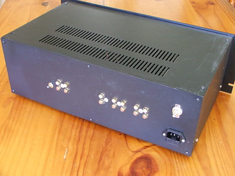

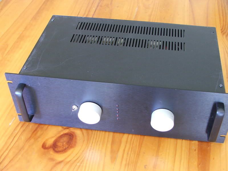

Front
Rear

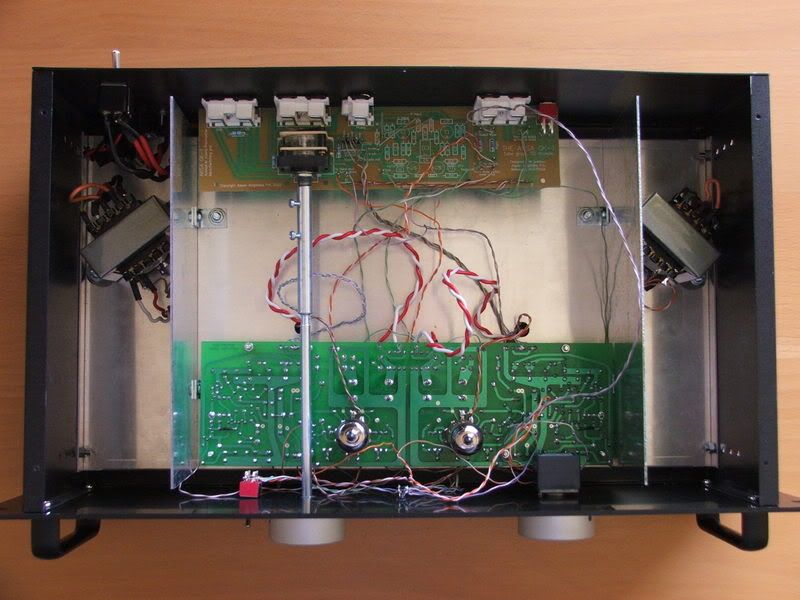

Under the hood
The internal wiring could be neater, however, I am not experiencing any hum at normal listening levels.  It ain't broke, so I ain't fixin' it!
Hugh was very helpful in explaining what wire links to make so that I could take advantage of 5 inputs without constructing the phono stage.  This would be a very handy mod for anybody constructing a unit without the phono stage.

Congratulations, nice approach in separating/shielding the boards and the transformer  :thumb:

You might like to try adding some Dynamat (or similar) strips to the inside panels to minimise any chassis resonance.
