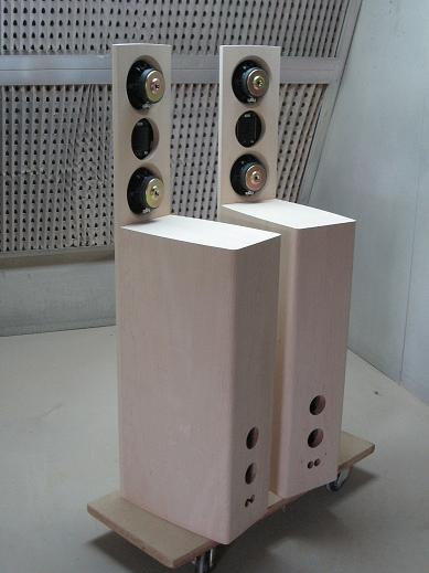

Ok, here's a few more pics. Baffles are next.  :thumb:
Cheers

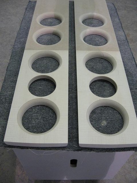

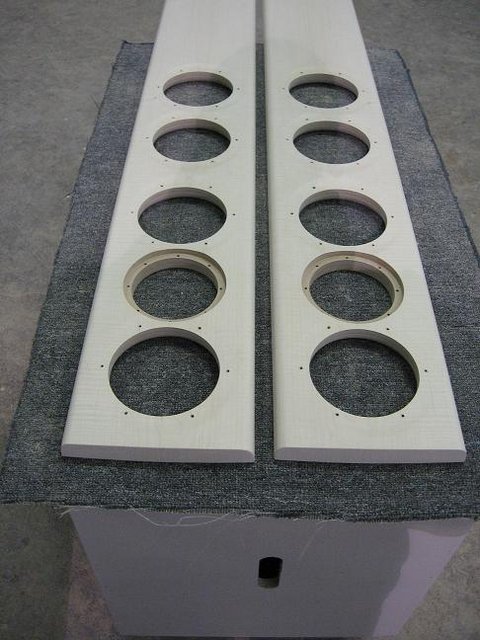

« Reply #33 on: 21 Nov 2006, 09:36 pm »
Ok, some more pics. Baffles are complete. The lines you see on the insides of the cutouts are the glue lines. The baffles are 1 1/8" thick. Three layers of 3/8" mdf.
Just one more final mock up, and they're off to finishing. :green:
Cheers

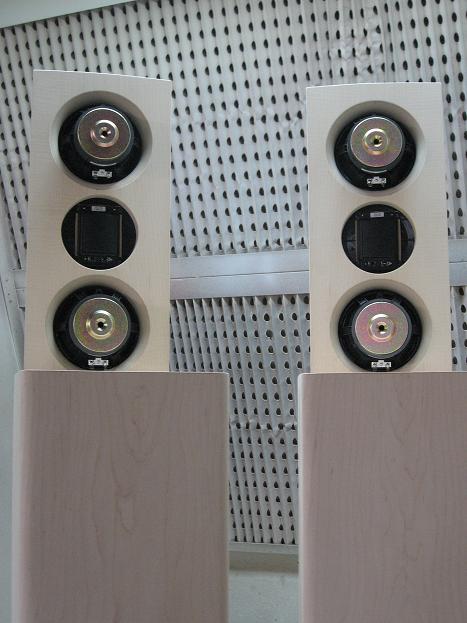

Here they are during final mock up with drivers mounted. This will give an idea what they would look like in a light finish. Mine will be quite dark. I'll post pics of those as well.
Now, they're off to finish. :thumb:

These were a challenging build. It gets real hard with all the curved surfaces. The baffles were particularly tricky, the front profile is curved as well and the edges are cut on a bevel to blend into the curved sides, so you don't have 90 deg. surfaces to work from, or register from. But I really wanted to have all the curves, and I'm real happy with the end result.
The veneer on the baffle was a bear. It was raw veneer, not paperback. It was something I had in the shop for a while. Sometimes veneers are brittle, particularly figured ones. This stuff was beyond brittle, just picking it up and it would tear. So the baffles ended up being the most difficult part, with the curved profile and the dished out parts where the drivers sit, was very time consuming. But again, the results were worth it.
