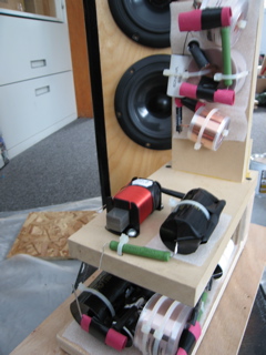

Glad you didn't mind me butchering up your design.
Could you check out the lower inductor on the tweeter section. I have it in line the mid inductor below it, but there is about 3" of space between them. That should be o.k., right?

Well, I just drilled holes large enough for each wire. A regular length drill makes it to the bass cab upper woofer hole.
The baffle is 1.5" thick. Two 3/4" pieces of baltic birch glued together. You need this width in order to not pop out the face of the baffle. You have to be quite careful when drilling, take your time, or, well, or, you might just cry.  :duh:
Same thing goes for the connecting the two mid woofs. I drilled into the cavity of the tweet and run the cable behind the tweeter.
If you flip the lower mid woof so as to have the connectors facing up remember to flip the polarity of the wires. Just simply cross them from one side to the other behind the tweeter.
I was going to just run the cable outside and even drilled the holes behind the tweeter. But I thought, yuck, I don't want to see the cable mess. So I got the synapz's working a bit.
