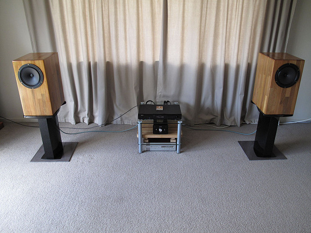

What a great and helpful thread. A bit old I know but has helped me relax my B200 Aperoidic speaker beautifully. A 1mH .28ohm 1.4mm air wound inductor in parallel with a 6.8ohm 10watt MOX resistor has done wonders.

 :green: Are those Omega Aperiodic 8s? Sure look like it. Mine sound great with the contour circuit.

Yes those speakers above are my take of the Aperoidic 8's. Coming from a large Fostex BLH I'm still not 100% sure they are for me but still having fun tweeking them to the limit.
