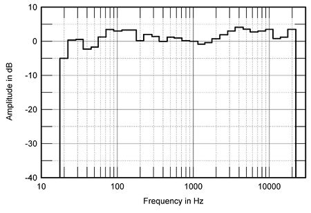

Here's a link to some measurements on the Studio 100 v3s.  I'm not an expert, so maybe someone else can interpret.
http://www.stereophile.com/floorloudspeakers/105paradigm/index2.html

Heres my take on the issue...
When you take a look at these 'in room' responses from JA, you'll notice a few things that are repeated in each of the measurements he took (anachoic, etc). See the rise that starts at 2k and up? Even though that seems minimal on paper, that is actually a 4db increase at 3k. From 1k to 4k is the exact frequency range that you are having issues.
The rise in db is likely two or three fold. Take a look at the speaker...
If you notice, Paradigm is using a 'waveguide' on their tweeter. It is essentially horn loading the tweeter to a certain extent. This is part of the reason you are hearing harshness in the upper mids and treble region.
The second issue is the use of a metal dome. There is a good reason the vast majority of 'high end' manufacturers don't use metal dome tweeters, they tend to 'ring'. I know, I know, B&W uses them. Well, if a metal dome isn't done 'right', they tend to sound very harsh. B&W has done a fairly decent (not perfect) job of taming them.
And the final issue that be contributing to the harshness is the crossover. Not knowing its design and parts quality, there may be poor quality parts that are employed (read = electrolytic caps on the tweeter). That one is a pure guess but if true, might be a contributor.
