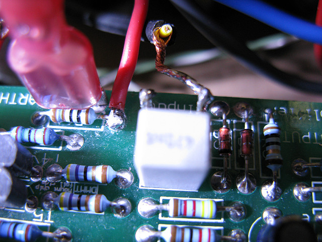

Aah - I see I need to upgrade my modules as they still have the square white cap!  :D
IMHO changing the input cap is not a 'must do' update to this amp, it's more like a personal taste and the effect depends on the character of the speakers and perhaps the impedance of your source. (i am driving directly from a Buffalo32 DAC) I read somewhere that big input caps also easily can pick up noise. When i put my finger close to the big one i hear i light hum. Allthough i think 0,47uf is a bit on the small side for a coupling cap. On the other side it's only a DC blocker. But Hugh must have it's reason!
Plz report your experiences here if you also try a bigger/other cap. You don't have to desolder the original one. i soldered it to the resistor near the earth connector.
Hi Hans,
Had Hugh fit 0.33uF Sonicap Platinum caps when I had your model (now have the Soraya 09).  Preferred the ultra clean presentation (compared with other caps) over any possible loss of base extension though never felt any serious loss existed due to the smaller size.  Very much personal preference for system balance as you say and my base was quite solid and tight.  The 1.00uF or 0.47uF VCap or Sonicap were just too expensive for me to get Hugh to try but would likely be the bees knees for transparency and extension.

Hans,
The size of the input cap is of less importance than the quality.  The Sonicap, and particularly the Mundorf Silver/Oil, are very good in this role, but horrendously expensive and bulky, so they must be mounted off the pcb.
