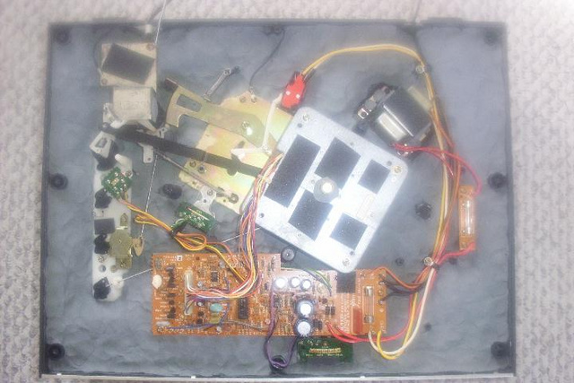

I did constrained layer damping (a more efficient type of bitumen) on my JVC cheapie bought from ebay.  It had little beneficial effect.  Nothing like the benefit 9 lbs of Plast-i-Clay made inside, outside and inner platter areas made.

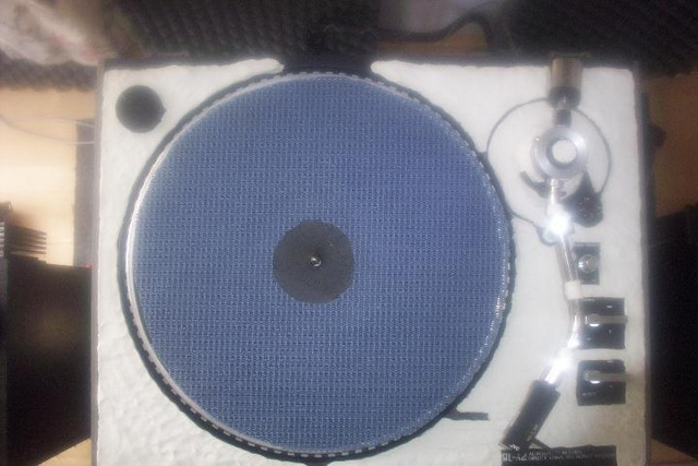

I just had to add this set of tweeks, tho not my own - it needed to be saved for all eternity.
A 'Zero One' of Australia wrote recently on VinylEngine.com about the list of tweeks he's done on his old  Pioneer belt drive table.  This man, whoever he is, is the King of all Vinyl Tweekers in my book....
Check it out:
Taking the pioneer here is a rough list of what I did in terms of damping, note however I have made other mods as well.
1. Tone arm wrapped in thin self adhesive cloth tape
2. Cart mounted using faom tape and no screws (contraversial I know but it sounds wonderful and no side effects....really.
3. Top of headshell covered in thin stick on cork
4. Cart body covered in cork (very thin) and then painted over with araldite
5. Stylus araldited to cart body (its a cheap cart)
6. Voids in stylus holder filled with blu tack
7. Platter sprayed with sound deadening spray
Cool Underside of platter covered in cork sheet
8. Perimeter of platter (underneath) has lead car wheel balancing weights attached to both damp and increase inertia
9. Cavity under platter filled as much as possible with both blutac, and non slip rubber matting
10. Top of plinth covered in non slip rubber matting and then mdf with cork, which is not machanically attached to plinth
11. Arm Board spereated from plinth by gasket of cork
12. underside of plinth has all cavities in metal moulding filled with blutac
13. Underside covered in non slip rubber matting and then a sheet of MDF attached to that twhich covers the entire underside except for the holes where the feet are
14. A matal plat that sits between the lpatter and the plint is also covered in non slip matting on the underside
15. all auto mechnaicals disconected and locked down solid
16. Heavy application of blutac around the bearing housing and the junction between the plater and spindle
17. Cool The wired to the motor lifted from the chassis and umbedded in blutac (it is a synchronous motor and a big one so it transmits a bit of vibration
18.  The sheild and cavity around the motor lined with non slip matting
19. The whol thing is mounted on squash balls then shot glasses half filled with water then cedar feet then a large sandstaone block then felt
20. The plinth is surrounded by thick but lightweight cedar.
21. Junction between counterweight stub and arm, wrapped in cork
22. Counterweight stub wrapped in thin layer of teflon tape so counterweight is tighter to stub
23. Cork placed between counterweight and rotating scale to stop small vibrations of scale
24. Hollow core of counterweight stub filled with blutac
25. Weight placed over vertical bearing on arm so as to reduce chatter, the wight was machined out of a video head (extremely effective and improved tracking as well)
26. One layer of teflon tape around cartrige shaft to make contact with arm tighter
27. clip for tone arm removed, it was loose and could vibrate, I use a rubber band to secure the arm to the support if needed.
Cool Hole cut in motor cover underneath the TT and a small plastic bottle cap glued to motor, a small plastic bottle half filled with oil attaches to this and it act to cancel some of the motor vibration.
28. Wiring for output now exits underneath the TT and will eventually run through holes in the support slab and into the back of the amp underneath, this reduces vibration transmitted via cabling.
29. Lots of different mats to suit different records and also a couple of weight made up
30. cover on top of motor caulked with blutac
31. Minor changes to rubber motor supports to counteract the uneven pull of the belt on the motor which causes the bearing closest to the spindle to compress too much normally while leaving the outer one unloaded.
32. Cork covering arm board (which is cast alloy)
33.  Talcing your drive belt ( a biggie)
This will keep everybody busy for a while...some amazing tweeks within the 32 listed  :thumb:
« Last Edit: 13 Nov 2006, 04:30 pm by TheChairGuy »
