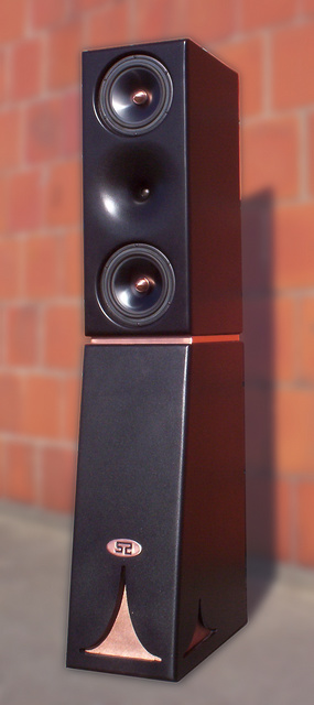

Folks,
Here's a recent picture of our Revelation MR-1 MKII in the base price Studio Finish - MSRP $9,995.00.  The copper trim is included in the price as well as all available upgrades.  Other hardwood trim options are available as well at no extra cost.  IMHO you'd probably want to stick with either a dark and/or reddish colored wood in order to compliment the copper phase-plugs of the woofers. -Bob :D

A nice understated elegance.  Somebody did a good job with this.  Wish it didn't cost so much.

Wow Bob that looks really sharp.  8)
So someone please tell me, is there a sizable difference in performance from Continuum' to Revelation? Is there more to it besides bass extension?

Obviously that's a subjective call, but I think you'd find that most - maybe all - of those who've heard the Revelations would say yes.  I'm one of 'em, and I can assure you that if I didn't think they were worth the extra $$$, I would've ordered a pair of Continuums or 2.5s instead of putting my heard-earned money down for a pair of Bob's best.
Although the SP Tech website says differently, I could have sworn Bob told me the 2.5s actually extend slightly lower than the Revelations (-3dB @ 23Hz vs. 25Hz), but there are two important differences  -
    +  First, the other MRS speakers drop at a rate of 25db per octave below 25Hz vs. 12dB per octave with the Revelations.  Consequently, the Revelations are able to produce significant energy even into the upper teens.  The other MRS speakers can't compete in that regard.
    +  Secondly (and most importantly IMHO), Bob's proprietary T-line is unlike any I've come across, and it produces the best, most accurate bass I've heard from any speaker or subwoofer.  The subtle nuances and idiosyncrasies you don't know are missing until you hear them are there, and the realism of the presentation is taken to a whole 'nother level IMO.
For me, if the bass isn't right, everything else suffers.  I'm no bass freak, but to me it sets the tone for the rest of the presentation, and depending on your tastes, may be the most prominent part of the program material.
Anyway, that's my take.  Hopefully Bob will correct any mistakes I made.
