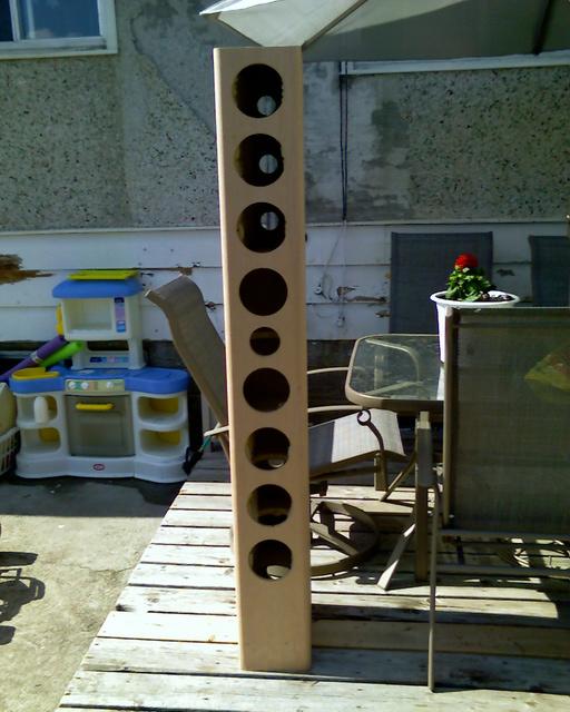

I got a little further today. I routed the tweeter and terminal cup holes (they take the same size hole) I also drilled the 2" holes with a hole saw and a drill press ....
Here is a pic of the center completed back
And then I put toghether the center sides, front, top and bottom ... I used brads and wood glue with clamps to ensure a tight fit.

Well I have the raw boxes pretty much done; three just like this :)

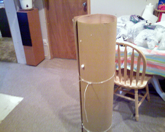

And finally the veneer ... I purchased three 4x8 sheets off of him. Al told me he spent 2 hours making sure they matched and even had some figure in them (this is regular straight grain cherry veneer). Who else gives you that kind of service  8)
I did leave it rolled up .. I'll take another pic after I am ready for veneer.

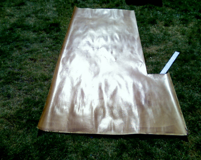

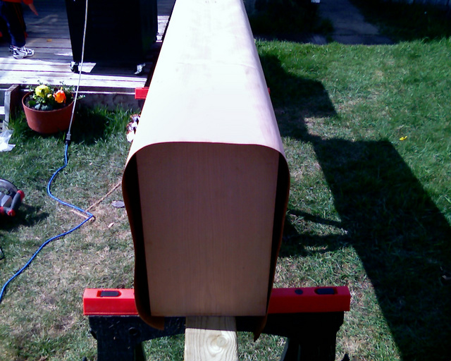

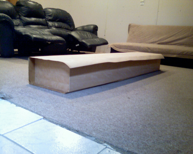

Ok nolw on to my favorite topiv ... veneering  :? . I've never been good at veneering ... getting better but still not by any chance perfect ... thought I would give the heat lock glue a try. It works pretty good ... not perfect but better than any thing to date ....
First apply a layer of glue to each surface and let it dry
I glued up the entire veneer sheet (per Al's instructions) ... then cut out the pieces I needed.
Here is a wrap

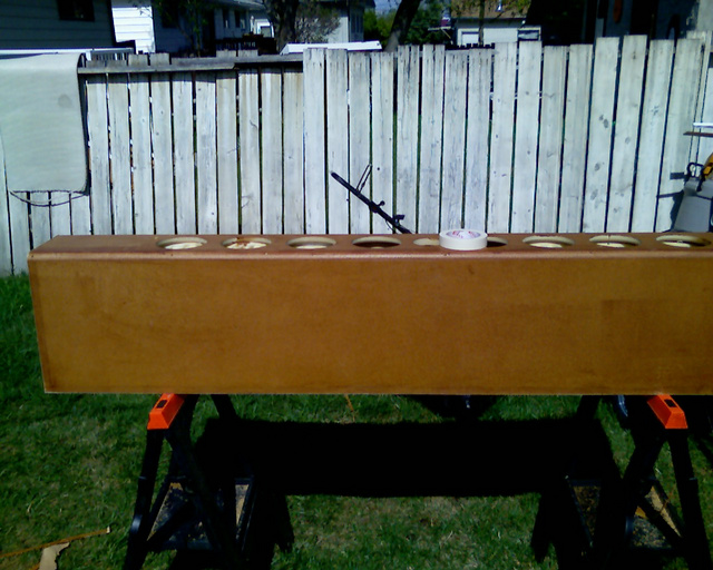

Oppse is he helping ?
Here are a few completed pics

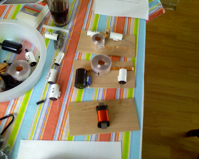

Not much more to say ... I've also been working on the crossovers (pics to follow). I hope to have them completed tomorrow ...

Oh I finished the crossover today
Any yes I took this pic before I added resistors to the tweet network.

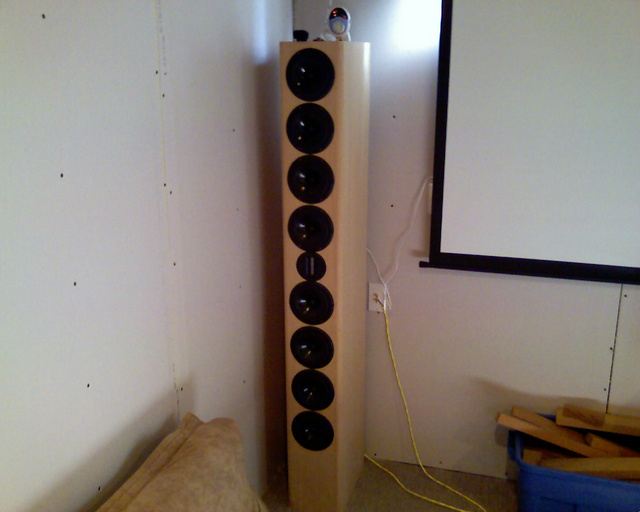

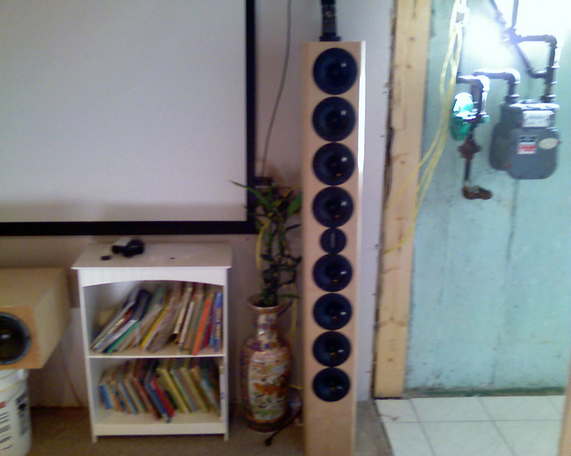

I also managed to the the two towers finished last night ... It was kinda funny, after just one night of listening (with out a matching center) my wife knew right away I was done ... I tested the old speakers for about 15 minutes just to get a last feel for the sound on a few passages then changed them ... about 30 seconds after I changed them I had my wife poking down stairs asking me if they have been changes ... "really different" was her words :-) They sound very good ... Now I need to get the center going tonight to see exactly how good the total soundstage sounds :)

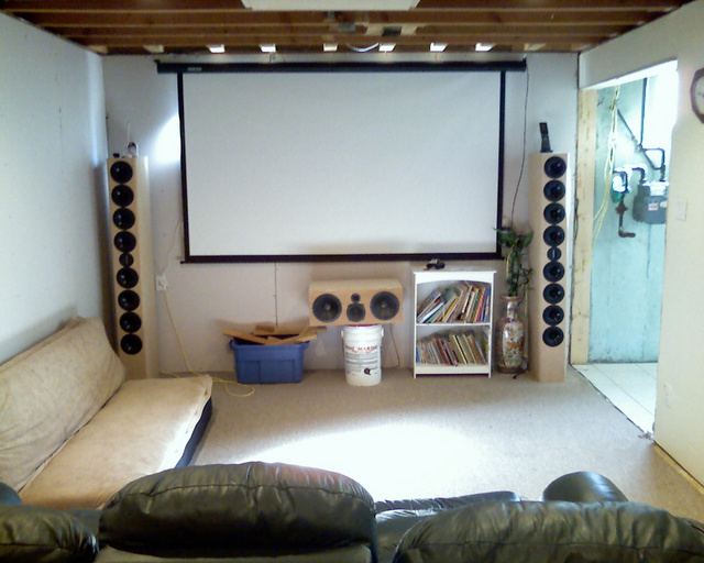

Ok I got the center done last night (sorry no pics here ... I'm sure I will find some tonight)
Anyways ... amazing is what I have to describe the sound ... clear is another ... speech has always been "hard to hear" unless I turn up the calibration on the center way to high ... of course that lead to other problems .... I have also never had a properly matching front stage ... now all I can say is wow ... speech is clear and there ... I can hear everything I'm supposed to ... both in movies and TV. Also I was playing with things last night and went outside ... I had not realized I turned it up that loud .. I could hear it clearly to the garage ... hmm .. always in the past if I turned it up louder it would hurt the ears before I got to loud ... not this time ...
I put on short passages from the following movies
Black hawk down .... very very good .. could hear the bullets and still hear people talking ... in the past that has been hard ..
Resident evil 2 .. say what you will about the movie the sound is fantastic ...
Star Wars 3 - opening scene .. wow things were buzzing around me every which way
War of the worlds - scene where the tripods first emerge ... again wow
Also it was amazing how the speakers melded ... it really was one very big speaker across the front ... nothing else to say ....
