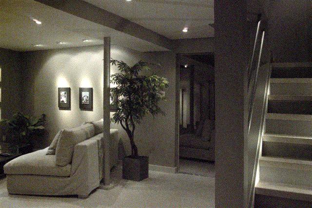

Here are pictures of the room  from the direction of the listening area.  The photos are in clockwise order starting from corner 1&2.  Sorry about the image quality, I shrunk the files down a little too much before I uploaded them.
