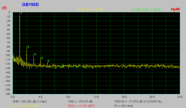

And here's Bill's (a physicist from Minnesota) FFT result on his built GB150D using his HP339A and  soundcard based analysis all with residual some 20dB below -
http://www.audiocircle.com/image.php?id=6462
My intention with this simple topology was not to have vanishingly low THD, but below audibility low order harmonics disappearing with higher orders into the (very low) noise. Was it Walt Jung who said a good amplifier has a low noise floor. < 110dBA re 1W/8ohm works for me.
Thanks Bill. :mrgreen:
