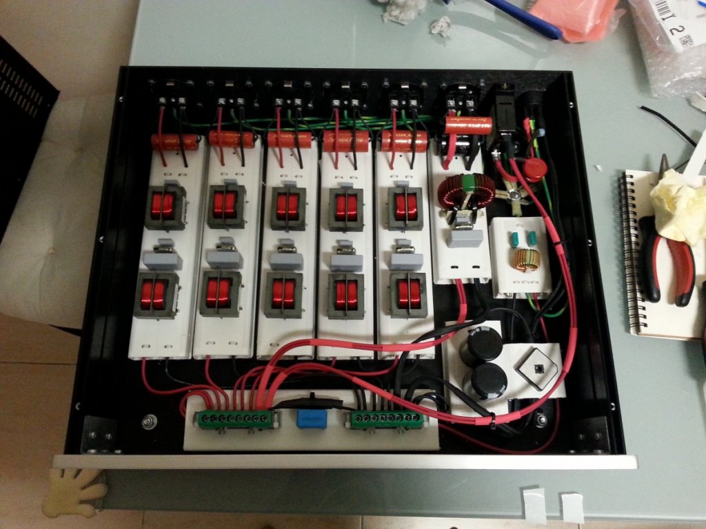

« Reply #426 on: 9 May 2013, 07:59 pm »
Hi,
I just wanted to thank you about your help on Felix, especially Paul (Occam)... ;)
Only last March I finished my Power Conditioner, based on Felix and some others....
Here is the result:
Basically is:
- modushop.biz Slim Line 2U Rack Silver
- Sources/Analog use two Coilcrafts P3717-AL, and Amplifier one Coilcraft CMT4-10-15L.
- Between the outlets and chokes I used the same philosophy as Audience. 0,1uF for digital sources, 0,22uF for analog sources and 0,56uF for amplifiers. The capacitors are Jantzen Superior Z-Cap and Mundorf MCap SUPREME Silver.Oil, all 1200VDC.
- Between chokes the capacitors filter +/- 1.4MHz (Vishay F1778 1uF), 7MHz (WIMA MP3 X2 0,047uF) and 23MHz (Vishay F1778 0,01uF).
- Schurter DENO 16A earth choke, and Kemet PHE850 0,0047uF for L > E and N > E.
- An extra Kemet PHE844 0,47uF, for extra filtration (before chokes), and to help on power factor.
- Bleed Resistor: KOA Speer MOS 100kOhm 5W
- A similar Bryston DC Blocker, Panasonic Aluminum Electrolytic 33.000uF 16V, Vishay Bridge Rectifiers 35A 1KV
- Over Current protection: Carling Tech Hydraulic/Magnetic Circuit Breaker 15A
- Surge protection: Hybrid MOV/GDT design - two (Littelfuse TMOV20RP275E + Bourns 2027-35-BLF) in series (L > N and N > L)
- Cooper bar of 80A
- Alpha Wire - EcoWire cable of 12AWG for sources and 9AWG for amplifier.
- Neutrik powerCON 20A, and 6x Socket SCHUKO MONACOR
- Flatfeet Ultra to isolate and prevent vibrations.
Regards  :thumb:
Edit:
2014.08.30:
 - Changed Amplifier choke from JW Miller 8118-RC to Coilcraft CMT4-10-15L.
 - Changed Surge Protection
« Last Edit: 14 Sep 2014, 08:22 pm by rdsu »
kyrill
Re: Felix project
« Reply #427 on: 9 May 2013, 09:01 pm »
Wow congratulations, looks like a high end professional job:)   :thumb:
advise: experiment with the very affordable WA-Quantum chips
some cmc coils look in series ?
rdsu
Re: Felix project
« Reply #428 on: 9 May 2013, 11:39 pm »
Thanks! ;)
Will have a look.
What chips do you use?
All in parallel. I think is the Coilcraft Third Order Filter design.
http://www.audiocircle.com/index.php?topic=25757.msg893971#msg893971
http://www.coilcraft.com/pdfs/doc191_CMFiltDesign.pdf
kyrill
Re: Felix project
« Reply #429 on: 10 May 2013, 08:02 am »
hi rdsu
on the photo I see clearly two coilcrafts on one white board  belonging to a construction for one outlet, so it looks like to me. 10 coils for 5 outlets. You mean that per outlet you have two coils in parallel?
rdsu
Re: Felix project
« Reply #430 on: 10 May 2013, 09:40 am »
hi rdsu
Yes, two coils per outlet for sources/analog...
Line      -----       ----        ----        ----        ----
                   CMC     Caps     CMC      Caps     Outlet
Neutral -----       ----        ----        ----        ----
Maybe is more correct to say that coils are in series?
kyrill
Re: Felix project
« Reply #431 on: 10 May 2013, 09:52 am »
yes they are, nor harm for preamps, source materials and so on. I see ypu have one  power amp outlet, why not two ( for future mono amps? :)
WA quantum fuse chips and power chips  have favourable reviews, There are also coil/transformer chips :)
I use them and kept them :)
rdsu
Re: Felix project
« Reply #432 on: 10 May 2013, 10:08 am »
Because I'm not seeing to buy them on next years, or will buy with RFI/EMI filtration build in... :)
If I buy something else will be better speakers for now...
I use one outlet to connect my plasma and tv receiver...
rdsu
Re: Felix project
