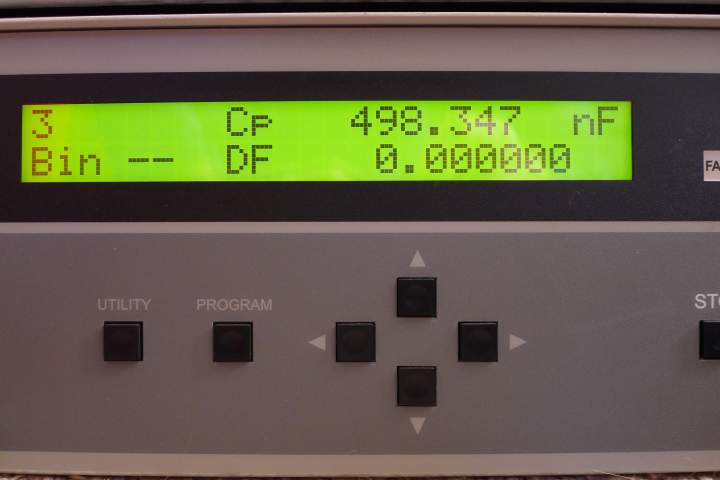

On the issue of capacitors to try with the Felix, and depending on your voltage and capacity requirements, Russian polystyrenes seem to be very good capacitors.  I have some on hand, and on DF they consistently measure better than the best teflons out there, this on a 6 decimal place DF measurement and on which the R-styrenes are almost off the scale.  I've yet to actually hear one of these capacitors, but being film/foil polystyrene encased in a hard, epoxy-filled box, they probably nearly compete with teflons (just can't get around that DA factor).

Check it out.  Russian potted polystryrenes for 40¢ a pop.  Off the scale.  That's a difficult scale to beat.
