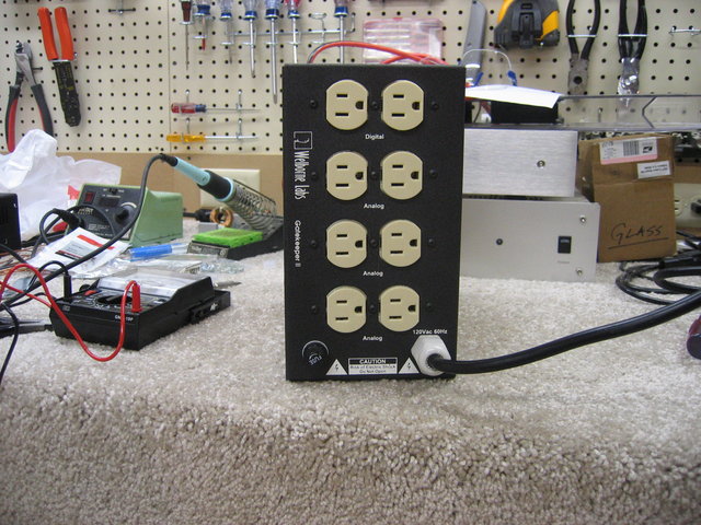

I put eight Felixs into a Welborne Gatekeeper, which was a very tight fit and, I assume because of the close spacing of the Felixs, an audible hum could be heard when I powered it up.  Once the lid was installed and the power filter was put behind the components, I could not hear any hum without my ear being within a foot or so of the filter so I didn't bother trying to correct it.
Kyrill, I noted that you recommended not putting two fuses in series.  I have that situation in that there is a 15A fuse for the Gatekeeper hot line and then I installed individual fuses for each Felix (3A slow blow and 10A fast blow).  Would this provide some sonic degradation?  I could simply bypass the 15A fuse noting that the other fuses are there to protect each Felix.  I know that my amp also has a fuse in series so that is 3!
I initially thought that the power filter took away some air in recordings but upon more critical listening it was simply a blacker presentation.  All of the information was still there and actually provided a quieter background to more easily hear ambient information that seemed to be obscured before.  My power filter is staying in the system.
Tom
« Last Edit: 29 May 2008, 01:18 am by TomW16 »

could you post larger versions of these photos?
i'll do it...
Tom
Tom,
How large is that enclosure?

The Welborne GateKeeper case is 11.5" deep x 9" high by 5" wide.  It looked like adequate room to start with but it ended up being tight.  It all fit in though.
Tom
P.S.  You'll have to tell me how you enlarged the photos.
« Last Edit: 29 May 2008, 05:20 am by TomW16 »
