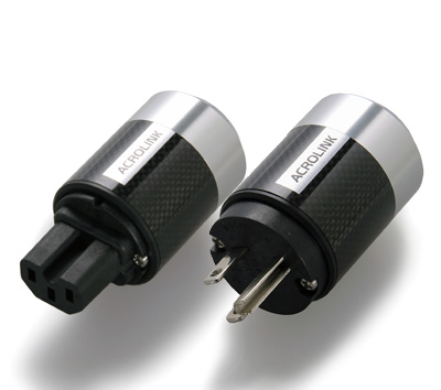

Gordy,
I would build each Felix for each component by using these male IECs to replace my power cords that will be sold.
Tan
