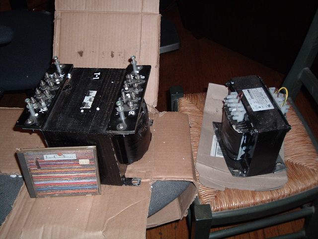

        Quote from: PT914
        ...No mods to the AKSA 100N+ but the best thing for bass that I did was...had been using a Equitech balance torodial transformer to run all the amps(they had a sale on only the trans). After building felicia power conditioner and seeing how great they were, I built a BIG one. Got a Signal isolation transformer that would handle the amps load and connected that in front of the Equitech trans. Put the caps between and I got bass, too much. I had been dialing the active crossover woofer atten to the 2 o'clock position, with 12 being neutral. Now it's at 12 and loving it. I have detail in the bass lines.
        Dang PT.... You're on wild and crazy guy  :o The last half of my 'Felix' was just delivered, and the DHL guy was not pleased. Neither was She Who Must Be Obeyed.
        The smaller is a 50lb 2kva which will feed the larger 70lb 3kva transformer configured for 1.5kva of balanced power.
        Anecdotally, there was an article in Audio Amatuer years ago which put caps accross the power transformers secondarys with supposedly the same effect. I'm unsure as to whether this is totally a powerconditioning effect or one that additionally deal with power factor correction.
        I just got off the phone with Billy at BGMicro and he keeps telling me that the 300+ 175va transformers on back order will (honest) be eventually delivered. He wouldn't tell me who in Austalia ordered 85 of them.....
        I'm slowly developing a less iron-rich approch to powerconditioning, but, at present, am not satisfied with the performance.
        The efficacy of any powerconditioning is very dependant on the nature of your mains power. Here in the Nasty Apple, Felicia has been a tremendous adjunct to those in the typical multiple dwelling units. In my own brownstone, which is removed from shared lines and somewhat distant from commercial/industrial draws, the effect is not nearly as pronounced, though now that I have it, I wouldn't have a system without it
