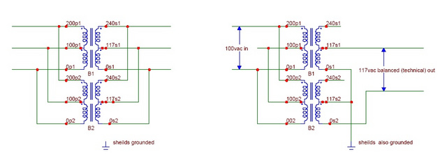

A rather unusual transformer just fell into my lap. This is a 25kg (55 lb.) CI (cut core) transformer with a pair of identical overwound (concentrically wound) coils with interwinding shields. In short, there are two identical transformers built on a single core. Right now the two transformers are connected to each other perfectly in parallel: the voltage of the big "doubled up" transformer stays the same as the voltage of the two smaller transformers comprising it, but the amperage rating is effectively doubled. It looks like it ought to be possible to reconnect the wires for balanced output . . . however somebody please tell me if my thinking is just plain wrong on this:
First, on the input side, I could put 100V into the 200V tap wired as shown in the photo. (Or, I could reconnect the 100V wires in series to create a 200V tap and run 100V into that.)
Then, on the output side, I could reconnect the wires labeled "117V" in the photo so as to give me a pair of 58.5V wires, which would be connected so as to give a balanced 117V circuit.
Is this making sense? Would there be a more sensible way of using this transformer for balanced power?

Short answer - Yup, you can rewire this C-core transformer to function as a 100v to 117v balancing transformer, albeit at a derated, half capacity.

First, hook up via the variac a voltage to the 0-200v primary leads. On the secondary, measure the voltage between 0-240, 0-117, and 117-240. If those voltages of the latter 2 are EXACTLY equal, and half of the first, the secondary windings are really 0-120-240 and the transformer does not need rewiring, simply  input 100vac to the 0-200vac primary connections and take 120vac balanced from the 0-240vac secondary after grounding the 117 output.
If not, long story short,  you'd do exactly as you proposed :), and rewire the tranny from this to that......
