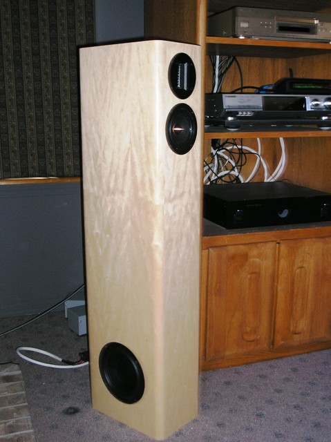

I received the demo pair of HT3 yesterday afternoon. These were the same pair that were shown at RMAF.
My first impressions are very positve. These have a VERY small footprint. They take up less space and are less imposing than my VMPS 626Rs on stands. Very high WAF.
They are less efficient than the 626Rs. My modded Panny SA-XR70 has to work a little bit harder.
They do  have a wider dispertion then the VMPS both vertically and horizontally.
The cabinet finish is very nice. Not quite up to the furniture quality of the VMPS MLS cabinets but quite a bit less money.
I have lived with four different version of 626Rs for about 3 years now. I am very used to that sound. The HT3s are a bit different so it is taking me awhile to get used to them. I can say that I do like the cone midrange a LOT better than most I have heard. There is no cabinet sound that I hear with most cone speakers. The mids are not quite as transparent as the 626s but still VERY good.
For a speaker that is less than 1/2 the price of my tricked out VMPS, to come even close is quite an feat. Great job, Al

Thanks for the photos Wayne.
And good to hear things are going well.
I will point out for those who may not know.
The tweeter in these HT3 is our RA104.5 motor with the last photo type face plate.
The responce is the same as the RA104.5 both vertical and Horizontal.
Last to change was the OD of the face plate Both OD, and bolt holes were added to this ribbon.
 :mrgreen:
For those looking and noting the 4 bolt holes not the 6 as on the RA104.5
