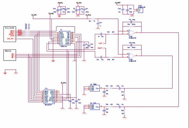

Anybody have the schematic that used to be posted on the Sean Adams website?
I did not save it, and it is not online anymore.
Randy
randytsuch
Re: Shall we DIY mod the Squeezebox 2?
« Reply #65 on: 30 Jan 2007, 06:10 am »
Thanks
Someone actually already emailed it to me, but I appreciate the post.
Randy
