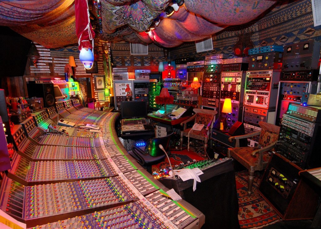

Is there an opportunity to further optimize the NX-Studio’s acoustic performance within a professional recording environment, thereby creating an even better tool for music production? How prestigious would it be to see Danny's NX-Studios gain the recognition they deserve compared to the highly regarded manufacturers listed below?
ATC (SCM100A/150A/300A ASL) — Active soffit or freestanding monitors built around ATC's own proprietary drivers, especially their well-regarded 75mm soft-dome mid. Extremely common in UK mastering and major mix rooms; prized for extremely low compression and distortion at high SPL.  https://atc.audio/hi-fi/loudspeakers/classic-series/scm100-2/
PMC (BB5, MB2, IB2S) — Transmission-line loaded monitors, a fixture in Abbey Road and many major mastering/broadcast facilities. https://pmc-speakers.com/studio/passive/ib2s/
Augspurger — Custom-built, often soffit-mounted monitors that are close to an industry-standard "if money is truly no object" choice for large mastering and mix rooms (paired frequently with Yamaha NS-10s as a nearfield reality check). https://augspurger.com/
Barefoot Sound (MM27, Footprint01/02) — Modern, widely adopted in top pop/hip-hop production rooms over the last decade; known for very flat, fatigue-free response.  https://barefootsound.com/footprint01/
Yamaha NS-10M — Technically not accurate by modern standards, but so ubiquitous historically as a "translation check" nearfield that it's still sitting on the meter bridge in a huge share of professional rooms worldwide, often right next to a much more expensive main monitor. https://www.soundonsound.com/reviews/yamaha-ns10-story
Genelec (The Ones series — 8331/8341/8351, and larger 1234A/W371A subs) — Probably the single most widely deployed serious monitor brand across broadcast, mastering, and post-production internationally.https://www.genelec.com/theones
Neumann (KH 420, KH 310/120 II) — Grew out of Klein + Hummel's studio monitor lineage; heavily used in European mastering and broadcast.  https://www.neumann.com/en-us/products/monitors/kh-420
JBL M2 / 7 Series — A standard in film mixing/scoring stages and many Dolby-certified rooms. Augspurger and custom soffit-mounted horn systems also dominate here. https://jblpro.com/en-US/product_families/7-series-products
Kii Audio (Kii Three/BXT) — DSP-driven, coaxial, cardioid-directivity design gaining real traction in mastering rooms specifically because of controlled off-axis behavior. https://www.kiiaudio.com/kii-three-bxt-lifestyle-listening/
Amphion (One18, Two18) — Finnish, widely used across Scandinavian and European mix/master rooms. https://amphion.fi/products/two18/
Focal (Solo6 Be, Trio11 Be, Twin6 Be) — Common in French and broader European post/mix facilities. https://www.focal.com/products/solo-6
