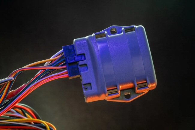

The KARR device is not just connected to an ignition cutoff, it is connected to every system in your car and cannot be easily removed.

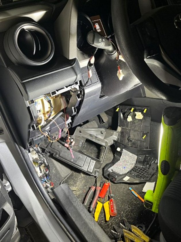

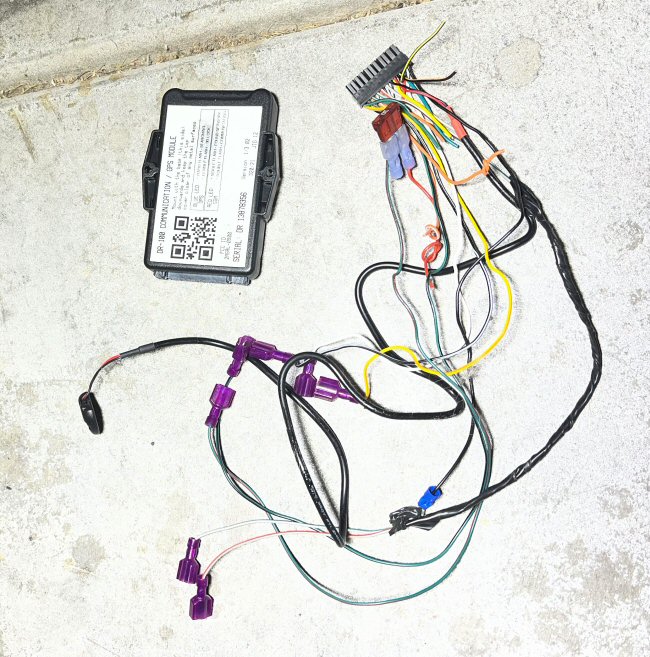

My brother just removed the KARR Security alarm from his wife's 2020 RAV4. They bought the car used and didn't know it had the device. He watch a youtube video and said removal wasn't that bad.
