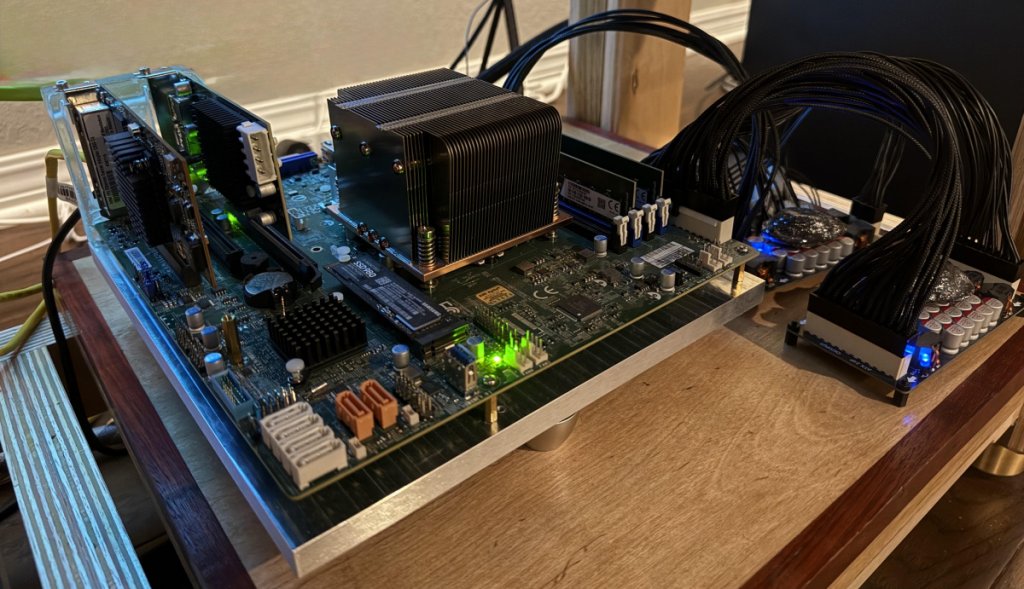

For the last year or so ive been satisfied with the sound im getting from my source, but the upgrade itch is back.
At the core of my streamer is a Jcat usb XE card and an LHY branded LPSU. Id like to upgrade the LPSU to something higher quality. The obvious upgrade choice for a Jcat card would be a Jcat LPSU, but id like to hear what your experience has been with LPSU's. What do you recommend?
My source uses a Jcat usb XE, Intel network card, and inline power filtration for the motherboard and cpu.
For software i use Jplay and Fidelizer.

That all looks pretty solid like you've taken very smart steps to minimize any noise issue from source. Plus I love the open chassis concept. I'd suggest possibly looking at next piece of the chain. What's your usb cable and dac setup? Also are you playing local files or streaming? What improvements are you looking to get? More resolution, smoother analog sound, more soundstage, etc?
Thank you for the kind reply fellow MTBer. My source has been a great excuse to learn new diy skills such as; resin printing, making silicone molds, working with epoxy resin, coordinating with cnc shops. Oh and software, less fun  :lol: More to come im sure!
Downstream from the source will be getting an overhaul soon. I am actively researching dacs and will be looking for a usb cable next. Currently im using an Oyaide usb, gustard U18, and the Technics SU-R1000s integrated Dac. I primarily stream but also have a small collection of local files.
By upgrading the LPSU id like to hear a lower noise floor, deeper black, improved timing, and in general a more analog sound.
