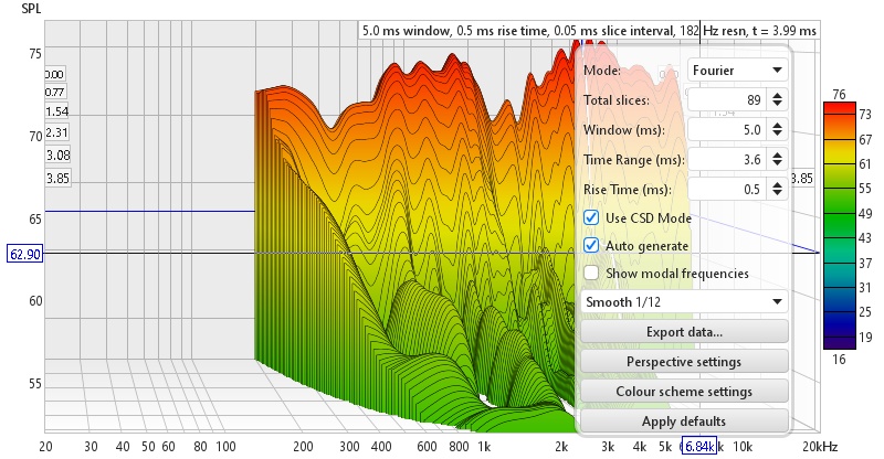

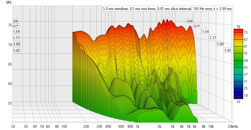

Found it at last - You can set the duration of the plot in settings. At 500ms you are displaying roon energy storage, at 4ms you are examing speaker energy storage.
With thanks to John Mulcahy (Author of REW)
https://www.avnirvana.com/threads/reconciling-the-waterfall-plots-from-rew-with-those-published-on-gr-research-clio-analysis.17105/#post-125173
Any thoughts on my speaker?
And without the menu
