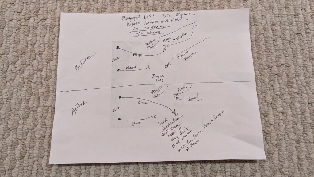

Steven, save your money and buy these stands off Amazon. Search for EZISE Universal TV Stand Legs for 35-75 inch LCD/LED/OLED TVs.
Each pair cost $29.89 You will need 2 pairs. They are very sturdy and will raise your LRS+ up 6.5"
To get the best sound out of them they need to be level vertical as well as horizontal. When seated in your LP your ears need to be just about in the center of the speaker.
I played with toe and found the best sound for me in my room was them firing straight ahead, tweeters inside with them spread far apart without losing center fill.
They can be placed very close to sidewalls.
Give them at least 3' from the front wall and 4' even better. Placing diffusion panels on front wall will increase their depth, bass, and soundstage.
To take them to the next level and do this simple crossover upgrade. No soldering just moving a few wires. Takes about 15 minutes a speaker.
Good luck,
Steve
Good luck,
Steve
Hi max190, thanks for the details about the DIYs which look very interesting to me.
I heard about the TV stand legs via YT but worried about the falling. I checked the look and it looks be able to keep the speaker firm. Would consider this. :) (edited)
About the placement, I found Maggie instruction recommended the setup more for AV and I am still trying different placement monthly. It's now about 2' from the front wall and 6" from the bookshelf on the sides. I have the tweeter inside and toed them in about 20 degree. Thanks for its light weight and I still can move it easily. Will give it a try with more distance behind and no toe-in. There are also books at the corner which I hope it does a bit of diffusion  :)
The last part (mod) sounds easier and very attractive. I'll see if I can make it without risks. I'm in Australia and it'd be very difficult to find a professional to repair it.  :|
