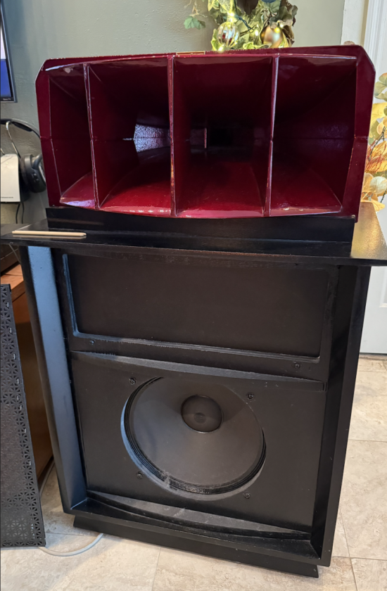

I recently acquired a pair of Altec Lansing Valencia 846A speakers. I have next to zero experience with horns, know very little about any of this vintage stuff. I got the speakers to "play with horns", and also a much higher sensitivity setup.

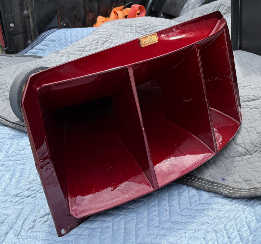

The woofers are the original Altec 416-8A, but the horns have been replaced with Altec 511B horns mounted on top of the cabinets.
The drivers in the horns are GPA 902-8A drivers.
Supposedly they have "Zilch 19 design" crossovers, and that is something I would like to play with a bit.
Wondering if anyone has a simple schematic for pairing this particular Great Plains Audio driver with this woofer, or similar setups.
I'd like to try simplifying the crossover setup, remove the hi / mid potentiometers, etc. I tried reaching out to Great Plains Audio for a basic network that would work with this horn, as I assume this is a fairly common thing? Left a message for them but no call back.
May try them again, but thought there may be some other examples of simple, known networks that are a good place to start.
So, I'm checking here. Thanks for any help / advice.
