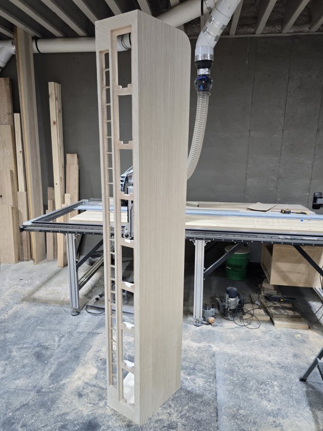

I got the first speaker glued up. I should be gluing up the second one tomorrow. Then some bondo, sanding, and paint. Then veneering the wing. At that point I will install the drivers and wire them up, then do some testing to make sure there aren’t any major issues. Last step will be to make the front baffle with the waveguides.

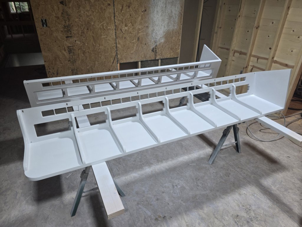

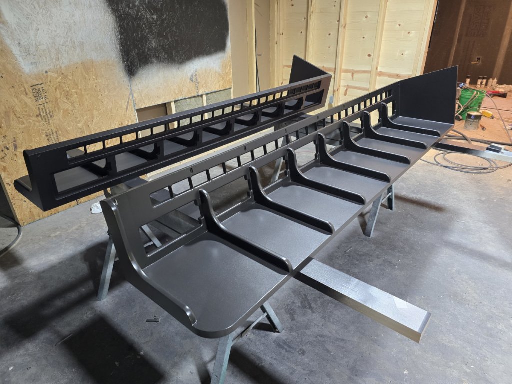

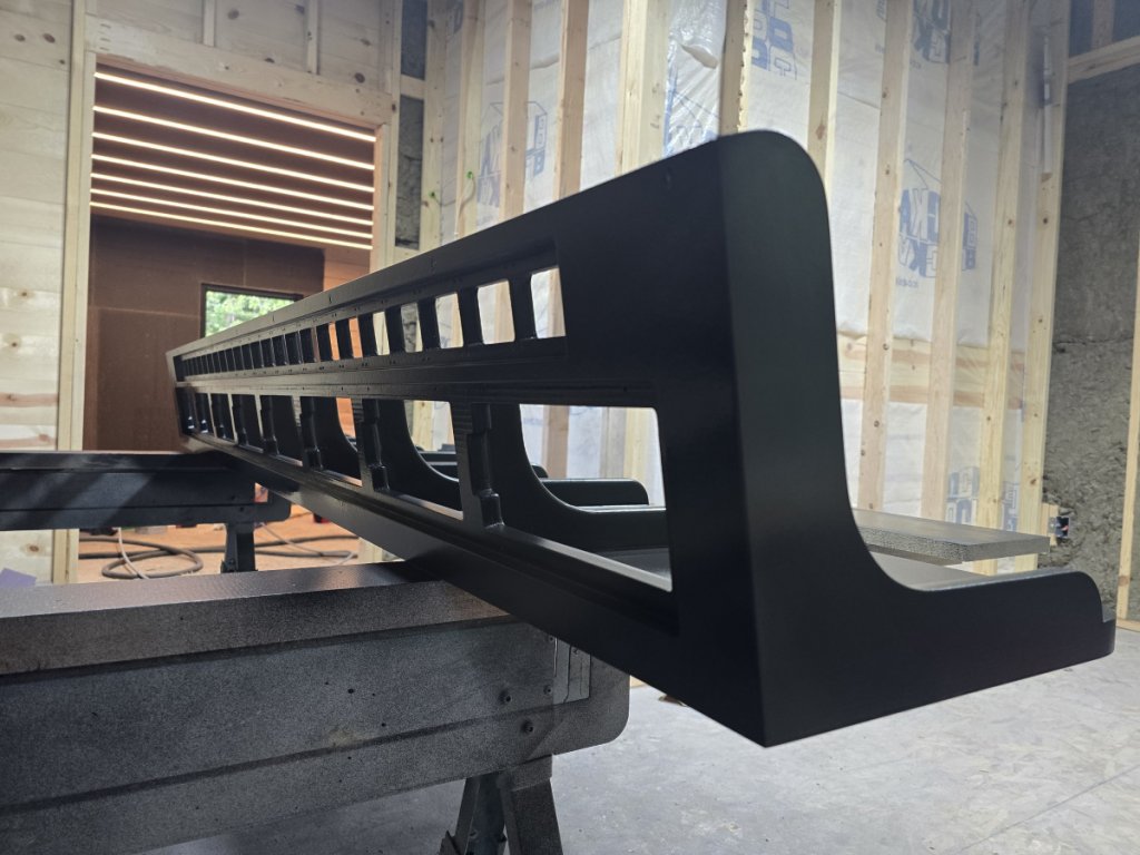

I didn't get a chance to install drivers this weekend, but I finished all the bondo and sanding prep, veneered the wings in rift sawn white oak, several coats of primer and several coats of SW Emerald Urethane paint. None of the paint will be on major show surfaces, but it still turned out pretty well. I'll be gone for a week and a half, so when I return the paint will be mostly cured which will be better for driver installation anyway.
