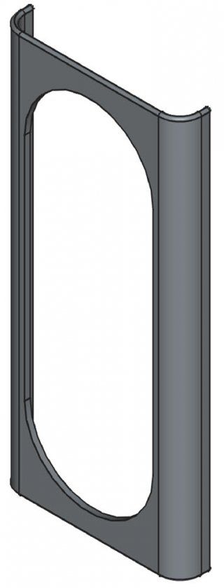

With both cabinets assembled, I turned toward my finishing stage.  While I do not plan to add grills to the speakers, I want to make provisions now that allow me to add them later if I change my mind.  My solution requires me to implement it before finishing the cabinet, so I had to address it before veneering.
I have not seen a speaker grill that is sonically transparent, and I'm having trouble imagining a grill frame that fits the speaker, looks good, and doesn't interfere with the rolled cabinet edges to form steps.  My first guess at a grill form is shown in figure 21, that I designed for 3D additive printing.
Figure 21: Possible Speaker Grill Appearance.
Grill cloth would stretch over the frame and be glued down.  It could have a flat face along the top edge that helps to hold it in place, or it can be open as pictured and fit across the speaker front and around both sides.  If the form doesn’t wrap onto the front face, the cloth will not be smooth, but the form will add a step around the speakers.

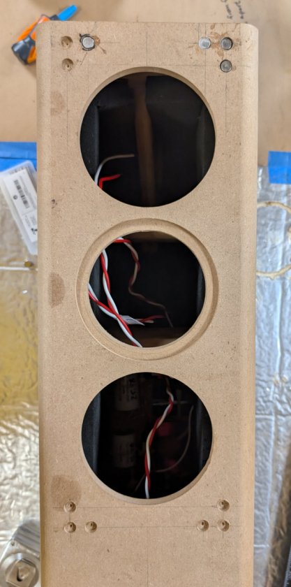

My solution was to embed twelve disk magnets into the cabinets’ front and symmetric to the drivers, as seen in figure 22.  A future grill frame can have metal strips to hold it in place if it is light enough, or companion magnets to increase the holding strength.  The frame can have fewer than twelve magnets if the extra hold is not needed.  The magnets are 3/4” apart, and each magnet measures 10mm by 3mm.  I used a 7/16” Forstner bit to drill recesses just deep enough to place the magnet faces below the panel surface: otherwise, they could cause lumps in the veneer.
Figure 22: Speaker-Grill Magnets Embedded in Front of Speaker.
I started attaching the magnets with super glue but found that I could also use the Titebond-III PVA glue that was used to assemble the cabinets.  It was easier to add the magnets in stages because their mutual attraction pulled them out of their holes and snapped together.  (I have two pairs of magnets super-glued together to remind me.)  I’m not sure of the physics, but I had a couple corner magnets jump from their holes and off the cabinets!  Also remember to index the magnets so that their poles are in the same direction.  If magnets are used in the grill frame, then they can also be indexed to attract to the cabinet magnets and hold the grill in place instead of pushing the grill away from the cabinet!
With the magnets installed, I was ready to start the final smoothing stage of the cabinets to make sure all the faces were flat and the end grains were sealed.

Thanks for posting your progress. I miss the days of detailed, instructive build blogs. It's a fair amount of work to post up here in addition to building but encourages others. I hope you'll consider linking in the "GR Build Threads" when complete. Even though it's kind of wandered from the intended path, I still think it's a good resource.
I also appreciate your out-of-the-box idea for grills, having traveled that road myself. Carry on!
Thanks, Peter, for encouraging me to continue.  I learned a lot from your threads, and I'll be starting to veneer in the next few day (hopefully).  I need to finish my "body work" on the cabinets to make sure they're flat and even.
I added a post to the "GR Build Threads" near the end, but as you said, it kinds morphed like many threads.  I hope to modify the post with a picture of my finished cabinets!
