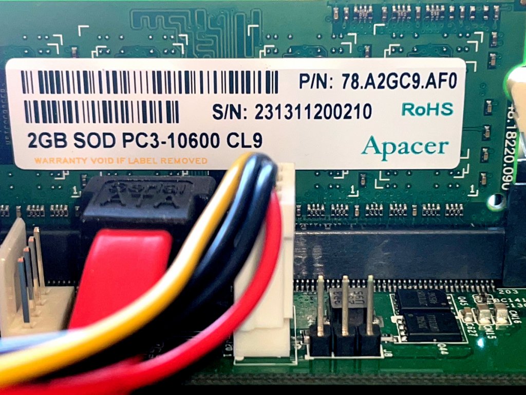

thanx for your valuable information. I really appreciate it. But i'm so very sorry to correct you... Soldered memory chips on the motherboard are used with the BDP-1. The BDP-2 uses a SO-DIMM module (2GB) which is quiet easily to be replaced (upgraded). Unfortunately, after an upgrade, i can nowhere see, how much RAM the system is recognising (BRYSTON help, please).

i figured it out, how to see how much RAM mem the system is recognizing or has installed... Just SSH the BDP and you can use Linux commands to explore the BRYSTON. I.e. 'free' to see the memory.
