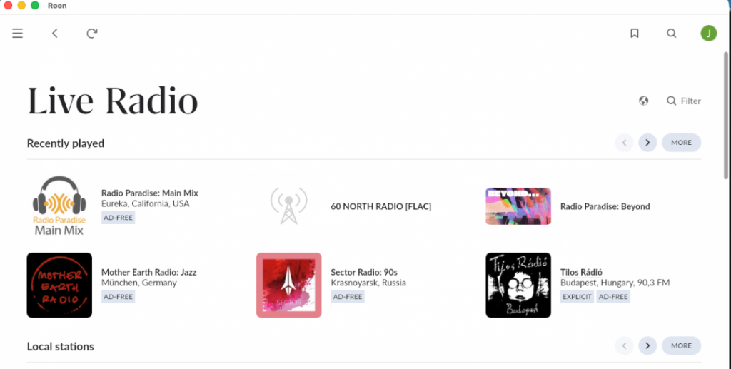

[quote author=christo link=topic=193746.msg2035887#msg2035887 date=1774915992
One thing I'd like to add to a wishlist for a new version is a more intuitive internet radio function, eg. just plugging in a link to an online stream and adding it to a list of favourites.
[/quote]
This basically what you do with ROON.  Add a URL and it pops into a window that looks like this.
