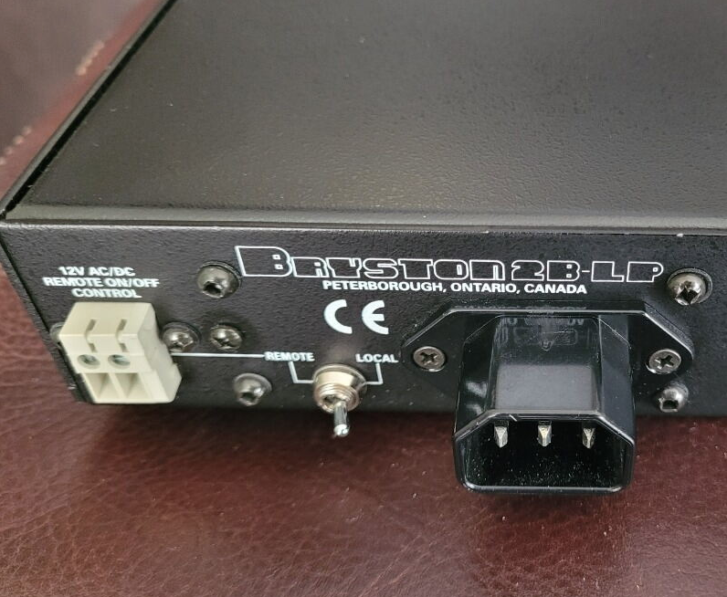

Happens to the best of us, same thing happened to my 2BLP powering my surrounds, one wire came partially but not totally out so wasn't obvious.  :scratch:
