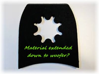

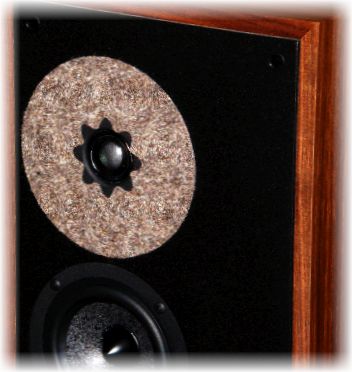

With so many tweeter felt designs available, how does one desipher what's best for their speakers? I've seen two examples available on the commercial marketplace.
https://www.madisoundspeakerstore.com/acoustic-damping/dampers-felt-defraction-ring-for-tweeters/
https://www.russandrews.com/us/focus-rings/
With all these shapes out their in the marketplace, as well as different configuratons fabricated by individuals, how do you determine what's best for one's speaker?
Here are a few references, to give better insight with felt tweeter surrounds, and front baffle diffraction.
