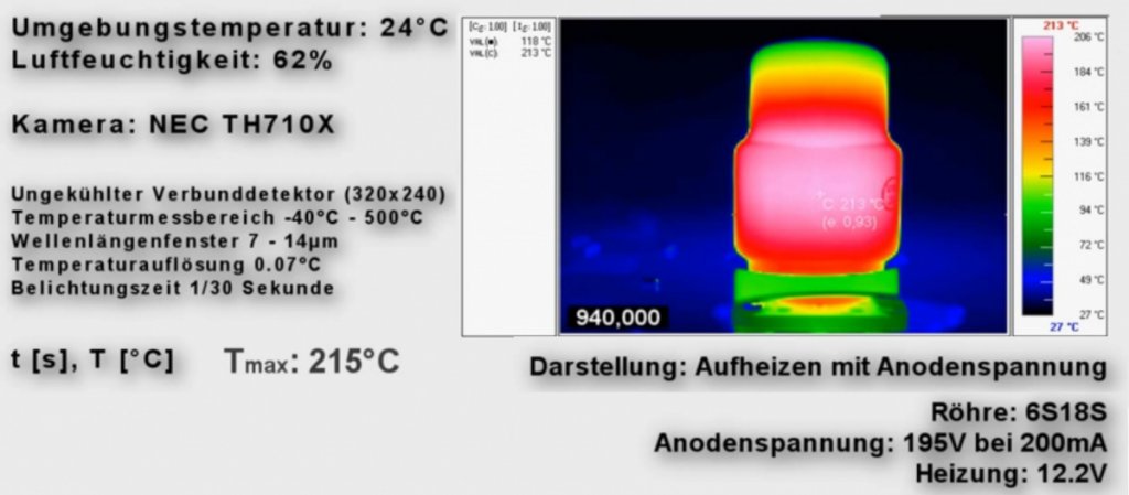

Some military tubes made wild heat 215*C with one tube.
