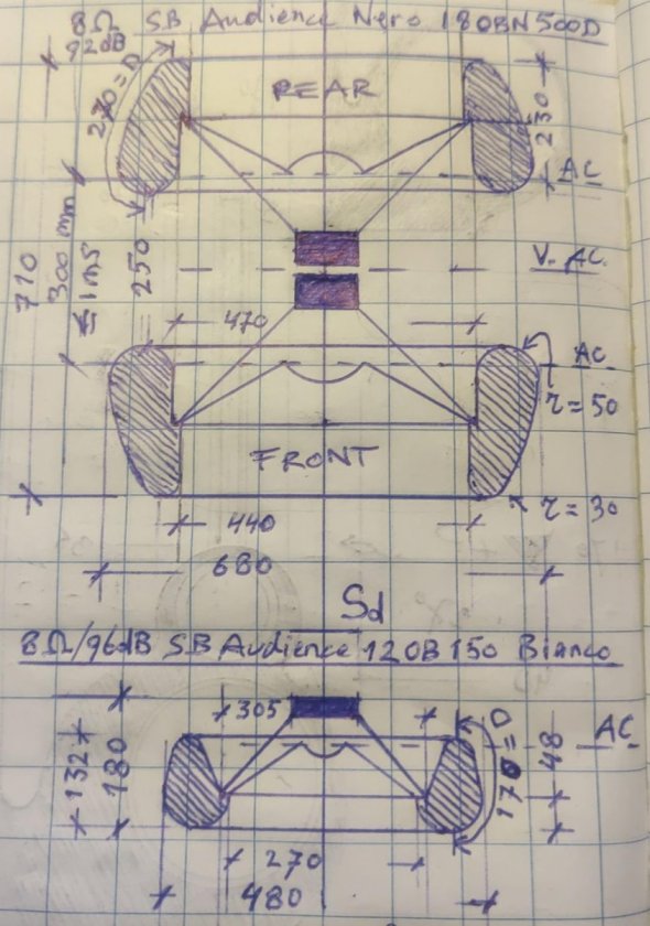

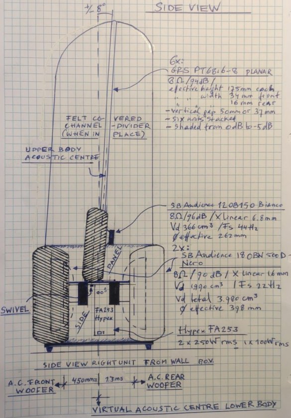

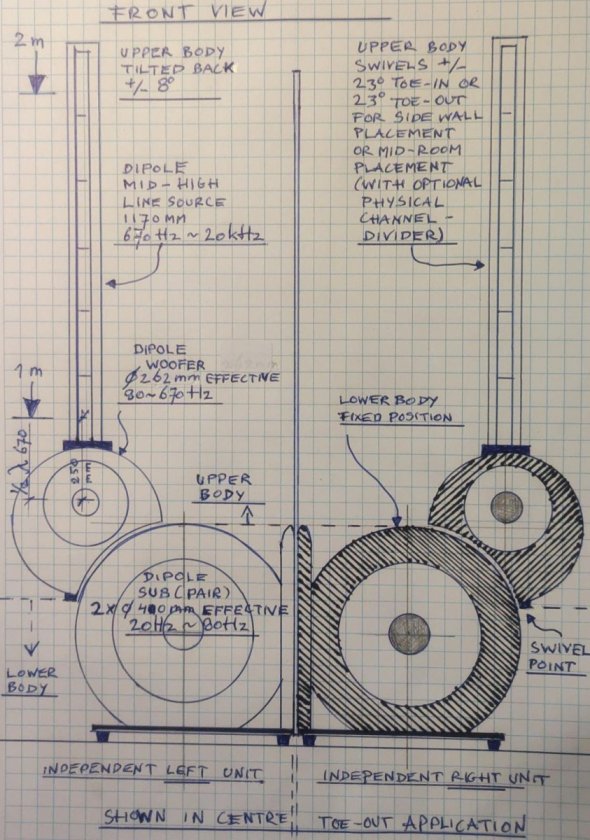

Above sketches illustrate a setup, but parts may move up/down/etc. since midwoofer radiaton suffers, section shows woofers too close, etc.

Line sources carry (most) sound further at -3dB per doubling of distance, but this behavior depends on adhering to parameters and decidedly falters below close to 700Hz, which is therefore the point where i plan to cross from one principle to the other. Room modes are said to make up for this faltering. But then we are back at a very close and limited near field!
Or are we? Dipole at bass freqencies typically has a 4.8dB lower reflected energy compared to monopoles at equal on-axis SPL (Linkwitz e.a.). Regardless of said -L. So i'll tune that up slightly, without losing the better near field behavour of 75% less reflected energy. Whaddayasay?
When i cross somewhat steeply at 670Hz, dipole behavior is still fully active, but room modes were just calming down in the upper 335-670 octave of the close-to three octaves this 12" (262mm effective diam.) driver would cover.

And the 670Hz-18kHz upper bodies are swivelling sections of the speaker pair, allowing both toe-in and toe-out up to 23 degrees, for central positioning in a room (avoiding a portion of early sidewall reflections in favor of late front&rear wall) as well as traditonal triangled or straight orientation. All in search of a near field as extended as possible within any room.

Familiar w/the vid. Are you referring to the U-shape and L-shape he's mentioning? As you saw in the sketches i'm applying those?
Although my U-frame is more of an asymmetric H-frame, but with distance D serving the same purpose. Held small enough to drive the Dipole Peak out of the operating range, but just enough to up the LF output a little bit.
As Finke (e.a.) observe, in asymmetric / non-equidistant cases the behavior of the radation pattern will be best at the less efficient side of the baffle and v.v., which calls for experiment on deciding which speaker to put right and which left in traditional triangle setup. In my probably preferred centre position, the best behaved side will face 'out' (to the side walls) joining the more efficient parts in the middle.
Baffle step doesn't seem a consideration in this design, as all baffles are tiny and well rounded, and woofers cross in omni range where dipole null is active. Null in line array is taken over by another (slightly similar) null based on the tweeters own pattern, starting somewhere around 2kHz. That's what i'm gonna try anyway. First point of order: measuring line array radiation pattern!
