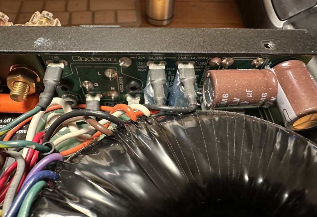

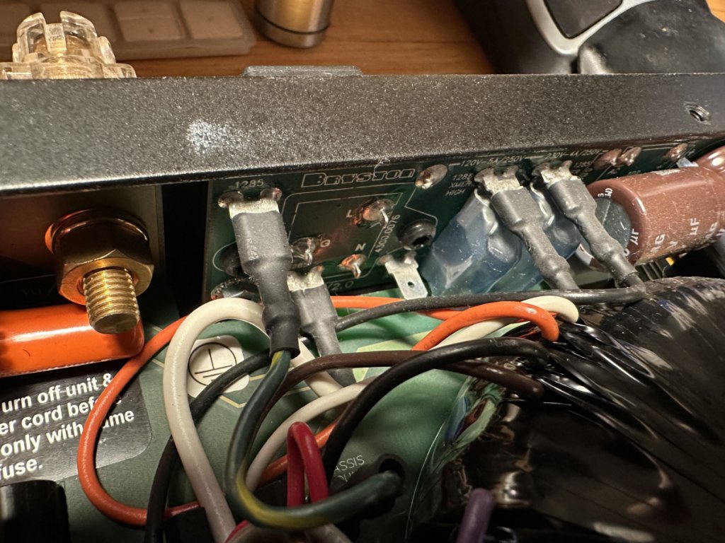

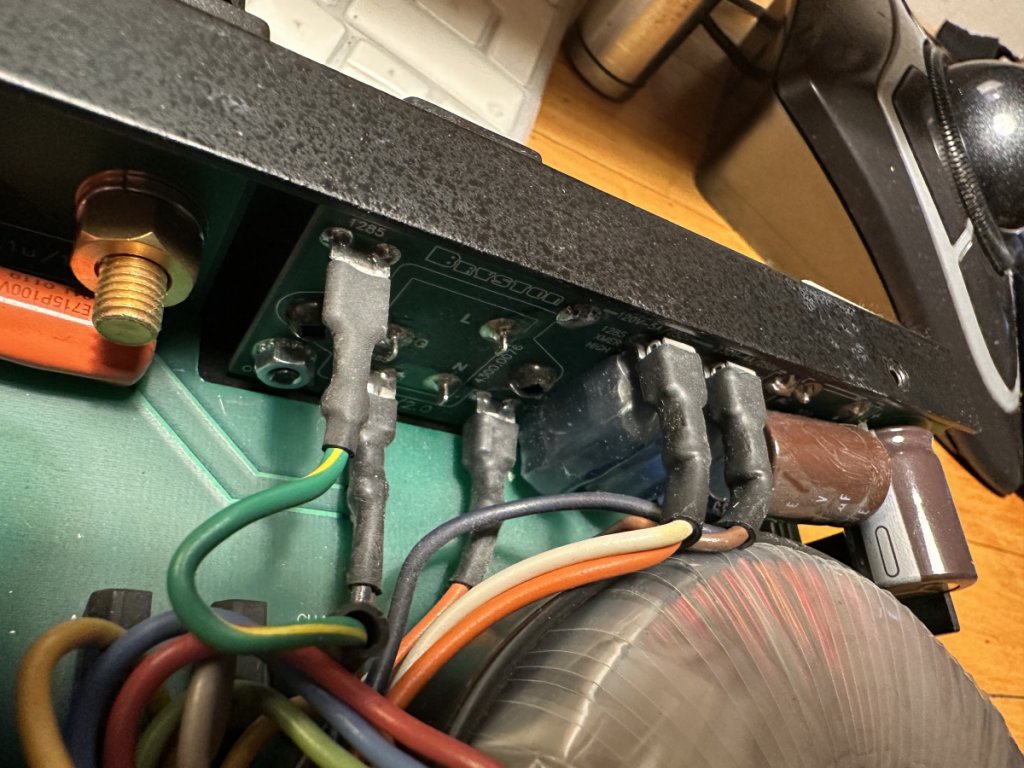

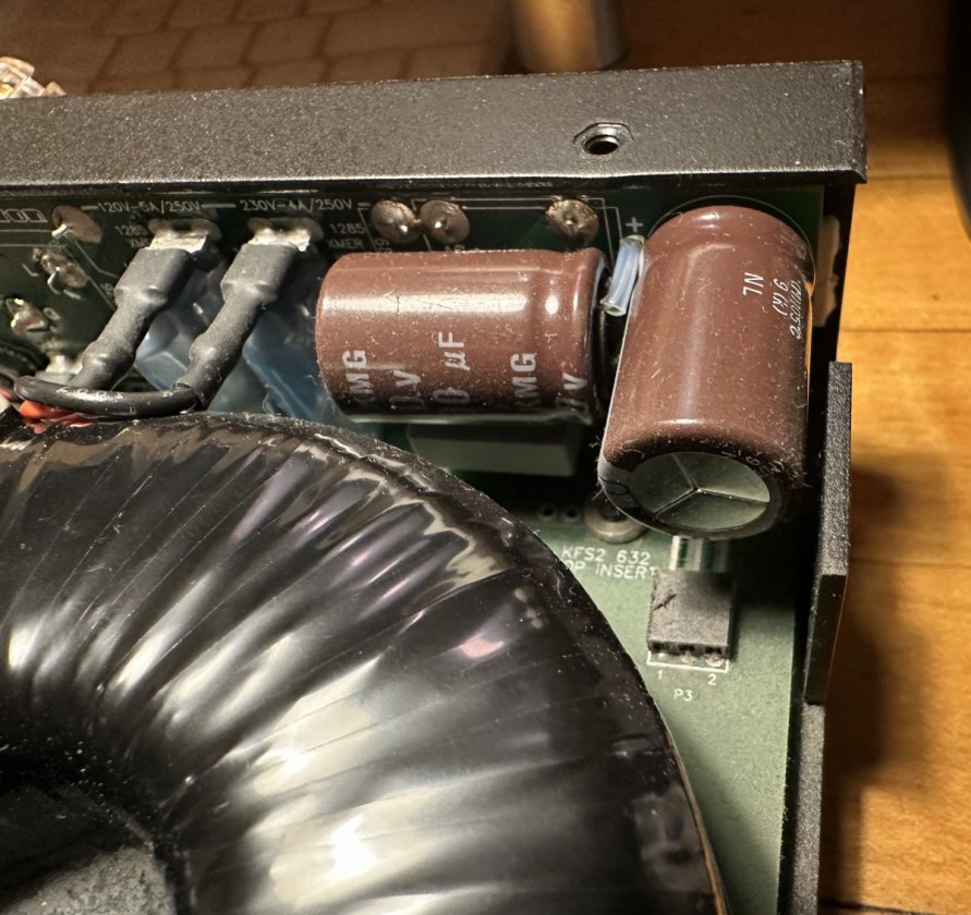

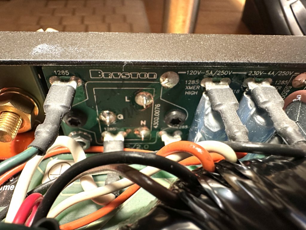

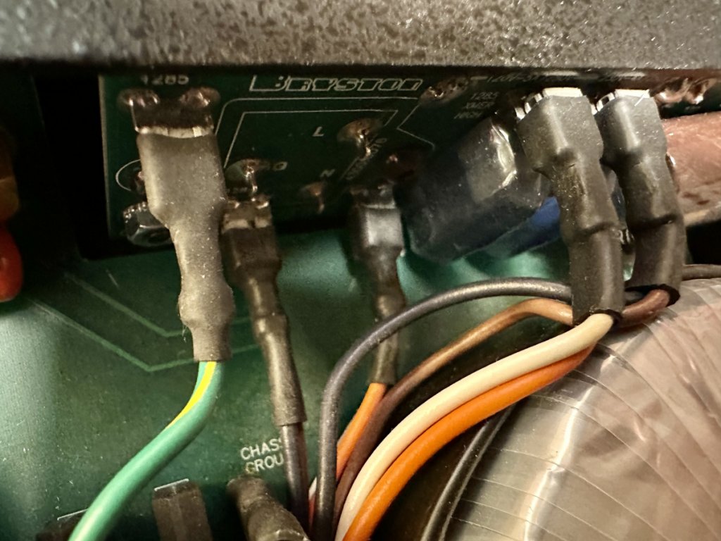

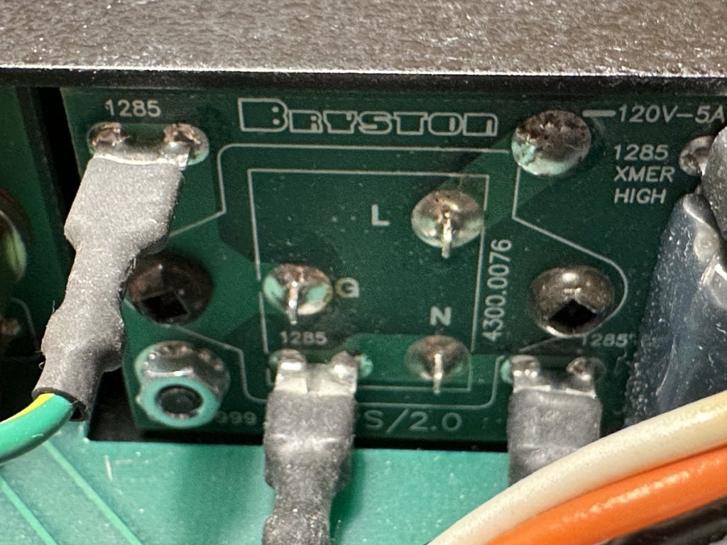

In preparation for the incoming 230 volt version I took a peek under the hood of my in house 120v unit.
Looks like the parallel connection needed for 120, Brown&Black and White&Orange are bridged at the PCB board but the fuses have a casing around them so it might be a little tricky getting the Power suppy board out as the main board may need to be removed first or maybe just the transformer.  :cry:
The 230 unit may have the same board so that the series wiring for the transformers is the same but unbridged, might be more involved so I'll leave it for now and just get a Step-up transformer.
I may get Bryston to do the conversion later in the year, also the unit still has some warranty so best not to tamper with the unit.

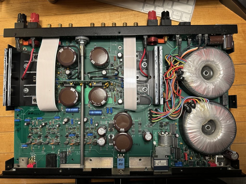

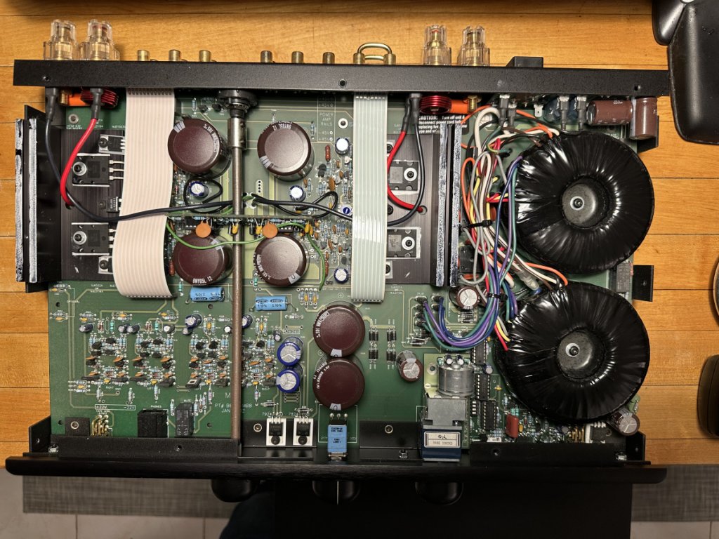

The B60R C  made it all the way from Australia..it's in excellent almost mint condition!
On with the innards. :)
I will not be doing any mods for now :nono:. and have  a 1000W step upcoming tomorrow, so hopefully up an running by the evening. :)
rob80b
Re: B60R conversion from 230V to 120V
« Reply #10 on: Today at 12:03 am »

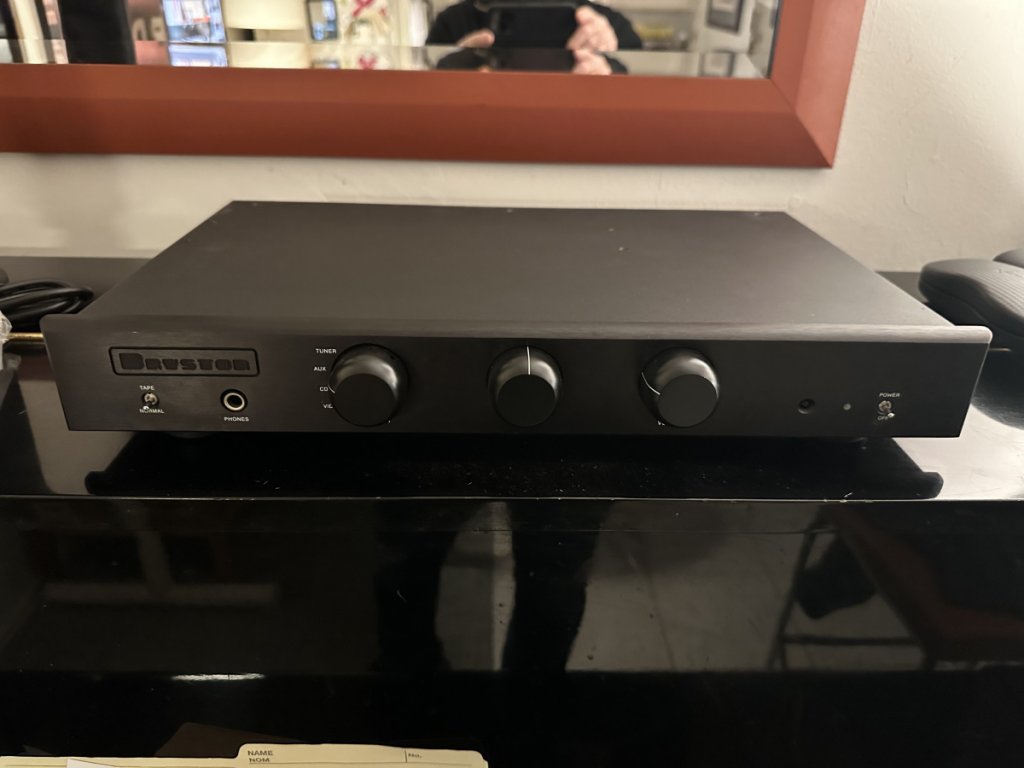

110 left. 230 right
Except for going almost all black pretty well untouched over the ten year span between the two, but happy to have one of the later B60Rs.  :thumb:

Congrats Rob. It looks great.
I have one with the same dress panel made in 09.  I opened it up once to change the dip switch settings so my Harmony remote would work. I don’t recall the transformers being black, but not sure.  I sold an older style B60 several years back and picked up a B100sst.  The B100sst is great too, fully remote, 12v trigger, maintains tape loop and pre-out main-in, more power, but unfortunately twice as big. I like the look of the B60 more.
