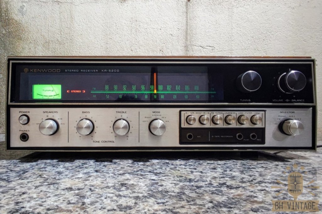

« Reply #8 on: Today at 01:09 am »
On vintage equips I like analog receivers only like the Kenwood KR line, why they have the beautiful green dial. I like to listen AM/FM radio when the weather is shaping up to rain.
