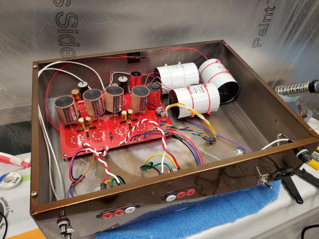

Yeah I remember you mentioning before and that spurred the thought of going custom chassis and removing any heat source outside. I also went for proper 630v caps instead of trying to squeeze out with 600v just in case it was pushing them closer to electrical limit. :scratch:
The Hammond chassis I'm using will be upside down (lid on bottom) plus the caps will be dangling down below everything else. Board will be offset about ½" from chassis to tuck small resistors topside and everything else hanging underneath. All tubes and transformers will be outside chassis. Fingers crossed we don't have a Kilauea situation, but you can say you warned me if things do get oozey.  :duh:
nlitworld
  • Posts: 2682
Re: New EL84 amp kit build :)
« Reply #36 on: 15 Dec 2025, 11:33 pm »

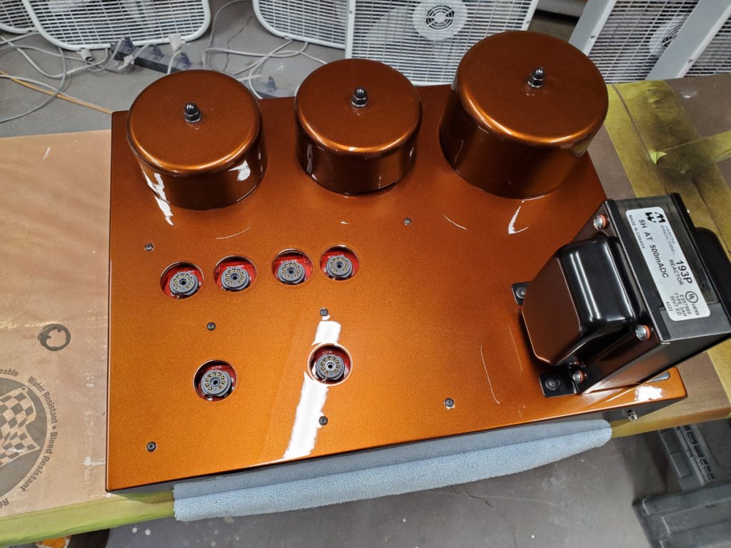

So progress has been made, and also stalled out. Was able to get 95% of the board populated with mountable parts, but I missed one set of the Amtrans resistors in the input tube section. They can get popped in easy enough at the end, but that section of the board will be TIGHT! I'll pop coupling caps in there at the end as well, since I need access to those resistors.
Anyway, here's photos. My butt is sore from sitting on a stool all day.
« Last Edit: 16 Dec 2025, 12:37 am by nlitworld »

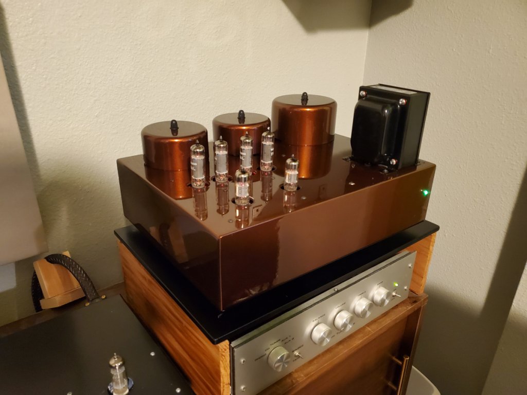

After a long weekend of pushing through assembly, it's done and playing music. It's got a little bit of ground hum, so I'll certainly look to redo the grounding scheme. Once the music plays though.... oh man it's good. Punchy, airy and smooth as can be. EXACTLY what I was hoping to hear.
Thank you everyone for your input, enthusiasm, and interest. Now time to blast some music.  8)
