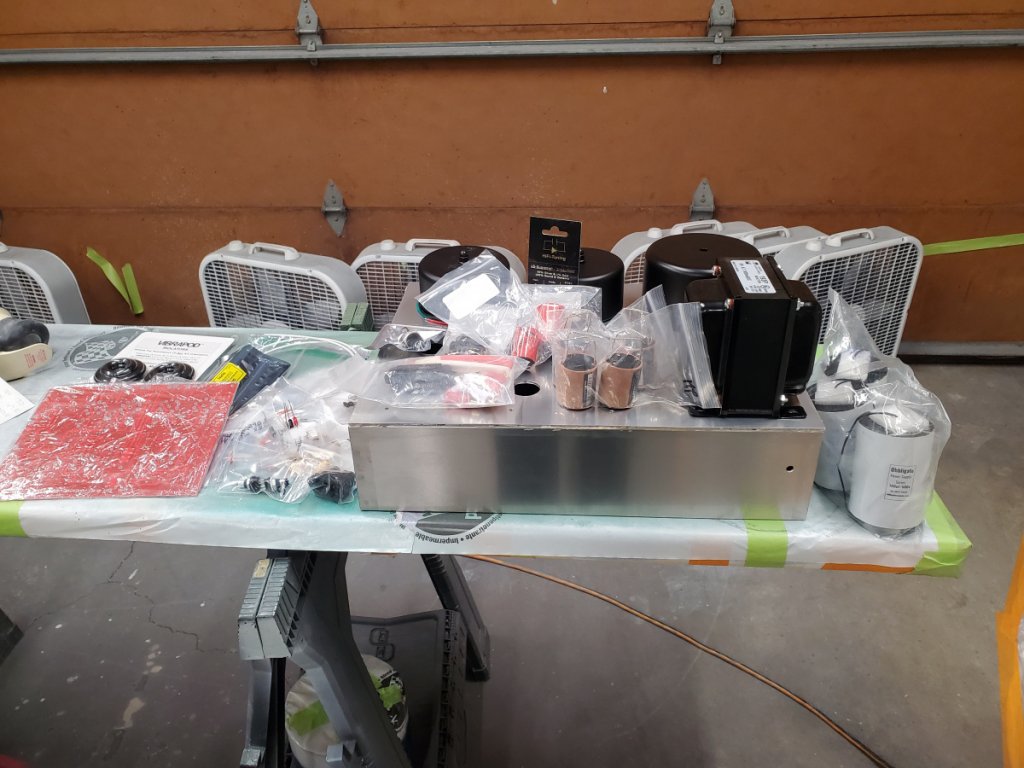

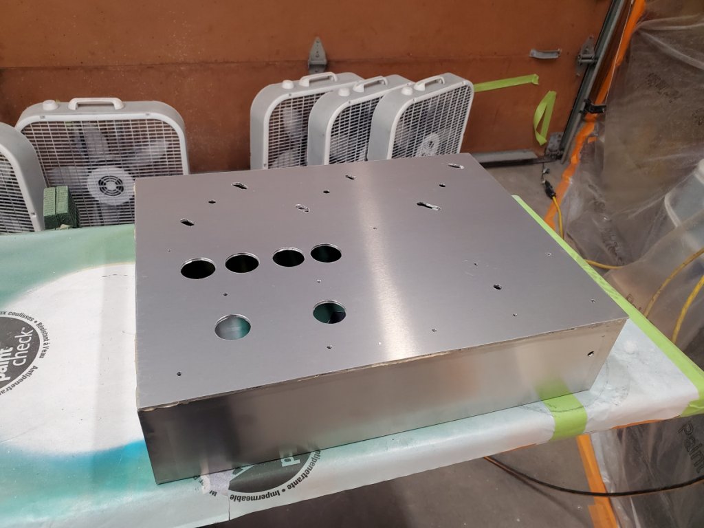

 So a while back I decided to build a tube amp for my system. Having success with Tubes4HiFi kits in the past, and seeing lots of good reviews on the punchy little ST35, I decided to jump on that and build from the ground up. I already have an EL34 amp for bigger power, so a little EL84 looked like a lot of fun. Circuit design appears to be same as the Audio Note EL84 kit, so I know the design is solid.
Since I was already going to build, I decided to go full regalia and build from scratch having only purchased pcb and transformers. Everything else I would source and go as high as feasibly possible. This involved oversize custom chassis (with thick 1/8" aluminum top plate for reinforcement) exposed tubes, exterior mounted transformers and a massive Hammond choke in the power supply. I decided to mount everything external due to the size of capacitors used in the build. There are 3 100uf caps in the power supply, so why not make them giant Obbligato film oil caps? It'll probably fit... :lol: Everywhere else got a minimum of Solen or Audyn mkp caps except the required 470uf electrolytic caps which gets the Audio Note treatment. Coupling caps are Duelund tinned copper. Wiring will all be VH Audio, connectors KLE rca and Tube Connectors. Top it off with Amperex and Siemens tubes, it should be pretty rad when it's all done. I'm still legitimately hoping everything fits inside the chassis easily. When I'm done, it'll end up close to 40lbs.  :o
Just thought I'd share the fun of the process as I finally have all parts together and holes drilled in chassis. Next step is prep and paint chassis, then bust out soldering iron. Hoping to make some progress over Christmas break.
Also big shout out to Dan @ Tubes4HiFi. He was super helpful filling in the blanks for parts list questions. Not surprised since his predecessor Roy was the same way.
Will update with progress photos as we go along.

Cool stuff! I'm following.
Off the wall question for you....there are six fans  :o What do you do with six fans? [I know. Silly question.]

IMO the output tubes are too close each other unless you live in Canada.

Let me get my notes together and I'll post full BOM. Transformers are all Antek with covers, but the giant black box is the Hammond choke for power supply filter. Needed 5H 350ma which meant that 10lb behemoth was kinda the only easy option. Seeing it in person is just comical.
Not silly question at all. There are actually 11 fans in the garage for basically turning it into a paint booth. 2 fans in back of garage, 9 along the door to pull air out, and crack the side man door for air inlet. My day job is selling automotive paint, so weekend hobby is painting silly stuff super wild fun colors. Bicycles, helmets, computer cases, SPEAKERS, dog show prizes, etc. Currently painting dog water buckets for Albany dog show prizes and raffle items.
Yep, I agree, except that's what is on the circuit board so that's where they stay. That is a major reason I made tubes exposed though. Not competent enough with circuit design and building to make things point to point yet. Also, I might as well be in Canada since I'm on Pacific coast about 4 hours south. Same rainy cold weather most of the year. Also why I built out a modded Douk amp for summer listening when it does get hot. 8)
