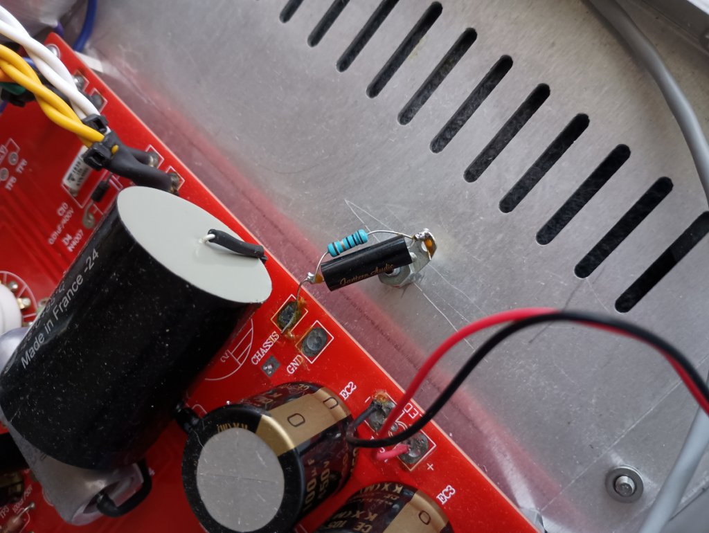

@nlitworld if you are still having some noise (& if you aren't already hooked up this way) take the Black & Yellow wires from the OPT & tie them directly to the 8ohm & Grnd on the PCB. Then from there straight to the speaker jacks. Disconnect the green wire as well from the speaker jack.. just cover it and tape it down inside.
Also the chassis & ground tab near the power supply. I went straight from that chassis tab to the chassis & put a Ground Breaker between the PCB tab & the chassis. A 10ohm resistor in parallel with a 0.1uF cap. I also grounded the IEC jack to chassis..no ground breaker. Made a great difference for me. I might try adding a Heater Elevator next.

« Reply #57 on: 17 Mar 2026, 12:26 pm »
I just did this yesterday & the resistor lead is basically just laying across the Chassis tab with a smidge of solder. I'll tighten everything up when I get everything complete. My wiring from the OPT to PCB is sloppy at the moment as well but I was just trying things out. Your build has encouraged me to go for a better chassis & top mounting the transformers.

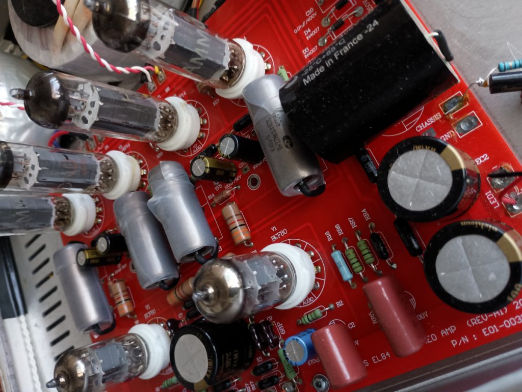

Also, your build is super clean and looks like you've already done a lot of the best upgrades with film cap in first power filter and around the ecf80 tube and pio coupling caps.  :thumb:

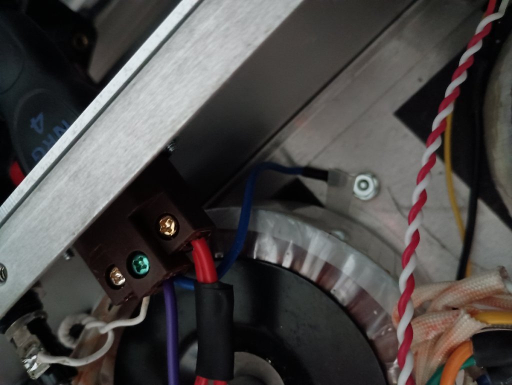

« Reply #59 on: 17 Mar 2026, 05:37 pm »
You can see in the photo where the Blue Wire (had no green) goes directly to chassis. What's also in the photo is the purple wire from the power transformer still connected straight to IEC. We want to connect that to chassis as well. Just pull it out and tie it to chassis. I had to add wiring because it was cut so short.
The best layout would be to give it its own connection to chassis with the shortest path possible. You should be able to connect it at the same spot as the safety earth (Blue wire to chassis in the photo) with no issues.. but giving the purple wire it's own connection to chassis is ideal. No need for a "ground breaker" here.
The purple wire in this power transformer is the shield. It could be carrying noise from the transformer. Leaving it in the IEC it could drain noise into our chassis via the new safety earth connection.
IEC Earth - chassis
PCB Ground - chassis (via ground breaker)
Transformer Shield - chassis
Try to keep them away from the input jacks or wiring the best you can for optimal results.
