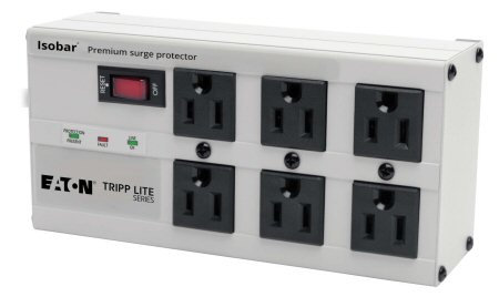

Bingo! But more outlets probably won't fix the sub buzz. Are you in love with your OB subs?
I have 11 pieces of electronics plugged into a standard 4 outlet receptacle. The Van Alstine Vision SET 400 amp and TV are plugged directly into the wall which leaves two outlets for everything else. My setup has zero noise.
I use a Tripp Lite Isobar Ultra 6 outlet surge protector as a distribution center along with a Panamax 5410 surge protector and various Felix filters. The Isobar is unique because it features isolated filter banks that provide extra protection:
  • Outlets arranged in 3 exclusive isolated filter banks to limit noise interaction among connected equipment
  • Blocks disruptive EMI/RFI line noise up to 80 dB that can cause equipment damage or data loss
  • Combine large toroidal chokes, ferrite rod-core inductors, HF/VHF capacitors and metal oxide varistors to block interference
  • The Isobar 8-Outlet Surge Protector has even more protection
https://tripplite.eaton.com/isobar-6-outlet-surge-protector-6-ft-cord-3300-joules-diagnostic-leds~ISOBAR6ULTRA
I love the subs they are the foundation to everything.  I read your post a few times over and not sure what a Felix filter is.  I did a quick search and couldn't find much.  Can you explain?  Is it something you purchase?
