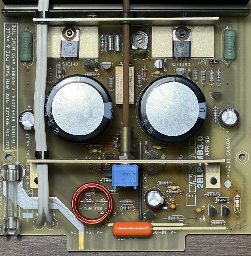

1)
I did NOT touch the Bias setting, because this is NOT required if you haven't replaced the SJ6521A  /SJ 6522A Power transistors and/or the drivers (SJ1490/1491).
When recapping a fully working Bryston 2B-LP amp (as in my case), you do  NOT have to reset the bias (leave well alone!).
2)
Also, I  did NOT replace the dodgey bias pot by a multiturn Cermet pot.
(I would have done this, if I was repairing a blown amp).
If you do not touch the old pot, I think it will hold on, but if you are planning to readjust the bias, it is almost imperative to replace it.
If the wiper of the old pot  opens  up temporarily whilst adjusting, you will blow your power transistors.
3)
If you would replace this bias pot I would advise to first determine the setting by measuring (with an Ohm meter), the resistance between the wiper and each of the ends.
Next, I would reset the new (multiturn cermet) pot such that it hase the same reading between the wiper and the ends.
4)

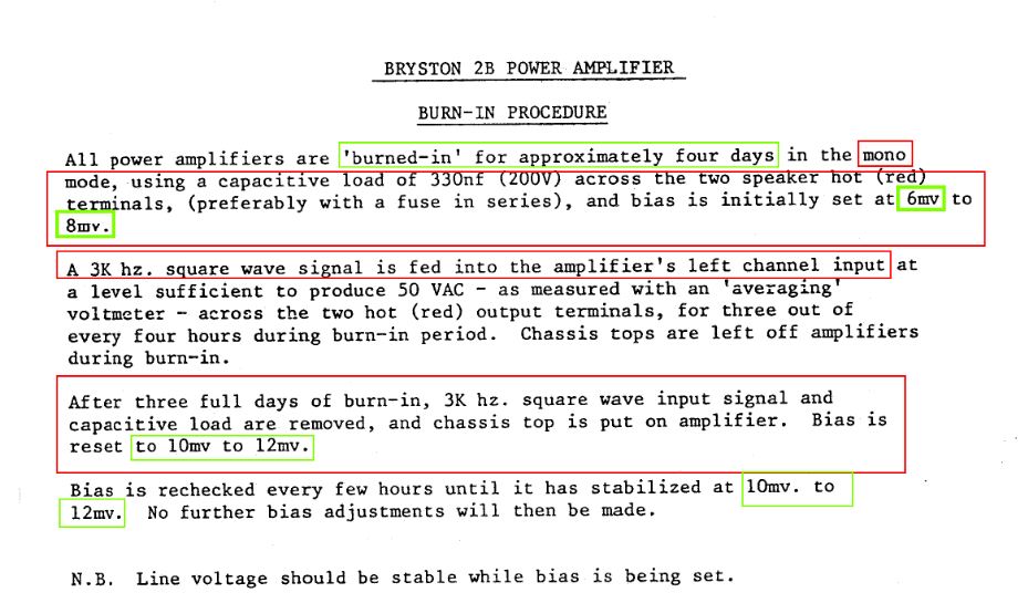

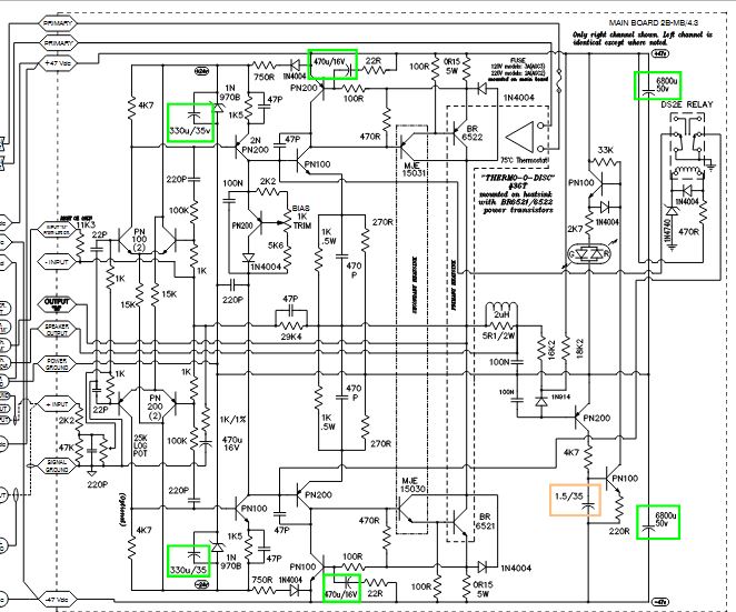

The procedure for setting the Bias is explained in Bryston's service sheet for the older (but almost electrically identical) Bryston 2B.
See attachment 3 for the procedure and attachment 4 for the correct schematic.
This file used to be on their website, but I cannot locate it anymore (I assume it is public though).
John Tullet has alaso provided a very detailed narrative on setting the Bias on a Bryston 2B :
https://www.audiocircle.com/index.php?topic=184949.msg1940311#msg1940311
5) Recommended Bias setting
The recommended bias setting (aged components and temperature stabilised) is 10 - 12 mV, measured across the green 0.15 Ohm power resistor next to TP1.

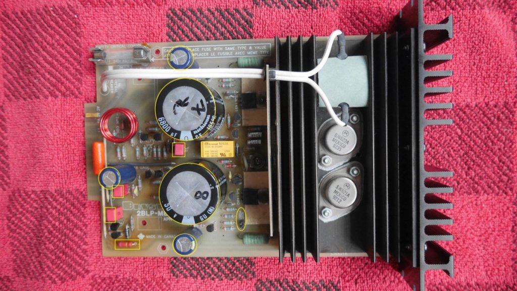

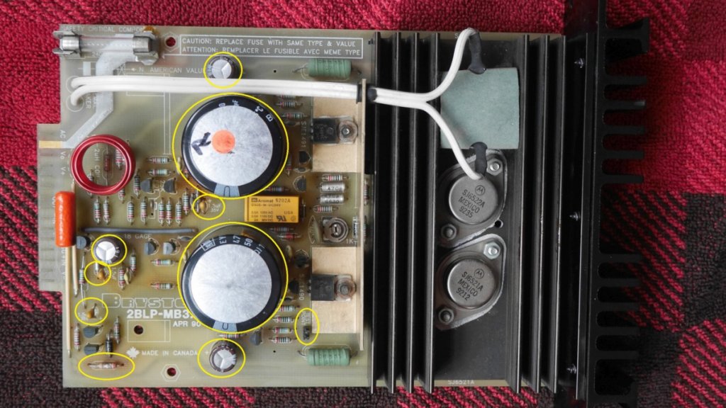

6) "Recapping"
Imperative:
2X ROE EYF 4700uF 50V 105 deg C by Nichicon 6800 uF 50V 105 deg C (Diameter 35m Height 32 mm).
Resistor for LED : 2K7 1/2W  to be replaced by 2K7  3W  Metal Film resistor :  Your one is already partially fried!!
Optional:
3X Chemiccon KME 470 uF 16V 105 deg.C by  Nichicon UKA 470 uF 35V 105 deg C or Panasonic FC 470 uF 35V 105 deg C
3x Tantalum KEMET 1.5 uF 35V by film capacitor WIMA MKS2 1.5 uF 63V
The tantalum caps have 50% safety factor (35V vs 24V  rail voltage), but KEMET nowaday prescribes much higher safety factors : 2-3 Times the rail voltage!!
I replaced these tantalums , just to be sure!
The Nichicon's  ( 470uF 16V) were still OK, the ROE's (4700 uF 50V) were definitely failing (bulged) and will then leak out a nasty electrolyte.

Well the parts finally arrived today, and I managed to get one side done tonight. Everything went well except for two minor unexpected things… first the holes for the main filter caps needed to be drilled slightly larger for the new caps. Not much, but a little.  Second thing was that I was surprised how easily the trace comes apart from the board where the traces are thin.  Got to be careful there.
I ended up changing the bias pots as well, as one channel had drifted and I was going to be messing with it anyway.  Thanks again Martin for the advice on measuring the setting of the pot in place and replicating that on the new pot before installing. Great tip.
The bias had drifted one one channel quite a bit.  I suspected something was off as one channel felt noticeably warmer than the other.
Left channel 12.6mv and heatsink at 37 degrees Celsius
Right channel 3.4mv and heatsink at 29 degrees Celsius
The WIMA caps I received look larger than Martin’s, and they just fit.   Maybe I ordered higher voltage, I don’t remember. The resistor was larger too.   Speaking of resistors, the old one measured about 6.8k, instead of 2.7k.  The led is now definitely brighter on the channel I completed than on the other.
Tomorrow I’ll do the other channel, then I’ll let it idle for a day and then set the bias one last time.
