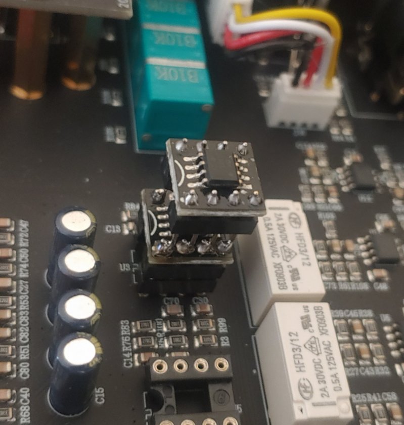

So obviously I simply had to try this :green:
Note the DIY fan setup to circumvent many of the potential issues of paralleling, but the sonic result is a resounding success.  This is not your well-heeled NE5532 sound.  While NE5532 usually sounds pretty good and balanced, it commits sins of omission when it comes to detail resolution, density, and solidity of music.  All these areas were quite improved with paralleling, to a shocking degree, enabling me to use the parallel version without regret in place of my prized discrete opamps.
While the best of the discrete opamps still have an edge when it comes to top-end smoothness and finer textures, the parallel version fights back with ear-grabbing colorful vividness and involvement of the vocals, which are proudly center and forward with density and richness for days.  I suspect some audiophiles will call this a more "analogue" presentation, as tired as the terms sounds, and I would have to agree.  The presentation reminds me of a good reel-to-reel tape type of sound or even a really well-recorded TDK metal cassette tape!  Those who treasure things like air and soundstaging refinement should look toward something like Sparkos discrete opamp, but those who treasure singers front center, thick and rich, paralleled NE5532 is an awesome way to go.  :thumb:

After getting such great results with paralleling NE5532, I just had to try paralleling LME49720.  I bought more from Mouser to avoid counterfeits.
Many recent offerings from China are shipping with LME49720 instead of NE5532, which is meant to be an upgrade, but since NE5532 and LME49720 sound signatures are fundamentally different, preferences can come down to system synergy.  LME49720 sounds pretty neutral and detailed but one can end up with the question, "why should I use it over others?"  NE5532 at least has a little more extra warmth and forward, analogue midrange, albeit with less liquidity and resolution.  Stacked LME49720 still sounds like 49720 but a little extra density and color is brought out.  It's still not as midrange-forward as stacked NE5532 but sounds smoother with more refinement, definitely worth trying in the right situation.  Just make sure the unit is well-ventilated and/or on fan.

I finally tried paralleling OPA1656, which is rumored to be one of Virtual Hifi opamp offerings.  Since OPA1656 comes in SOIC, making this is much more complicated than paralleling DIP-8 opamps like LME49720 or NE5532.
Steady hands and good solder tip are required, and even then, I could only come up with 2 working opamps out of 3 I made, two of which I had to resolder due to causing some faint ticking noises.  It's a shame this is not easy to make and runs hotter, since this paralleled version sounds much better than OPA1656 with much more bass power and presence which makes the midrange richer and warmer. Actually, there is more detail resolution in highs and mids also. It's transformative!
I wish there existed an adapter to solder two SOIC dual opamps into one DIP-8 dual opamp!

After paralleling OPA1656 (FET-input CMOS), I naturally had to try paralleling OPA1612 (Bipolar input), which boasts even lower noise and THD+N than already spectacular OPA1656.
In stock form, I thought I preferred OPA1612 due to significantly more presence and definition in the midrange, compared to which OPA1656's midrange region almost sounded a bit scooped out and laid-back, giving the impression of a bit of "V" shaped sound.  When paralleled, OPA1656's midrange gains presence and richness, bringing it in line with the rest of the ranges, making it one of my very favorite-sounding opamps.
Paralleled, OPA1612 adds to its already-impressive resolution and clarity, with nothing veiled, cluttered, or confused.  Bass is super-defined, similar to a sealed bass woofer, which reveals the above midrange without bass interfering.  All of this adds to a clarity and detail monster, which is less kind to poorly-recorded music, especially ones with hyped brightness and thin bass to begin with.  This is for systems that lean to the overly warm side or for systems with great subwoofer or two that can be adjusted to bring out some extra warmth and balance. Then, it would be "reference" sound.
