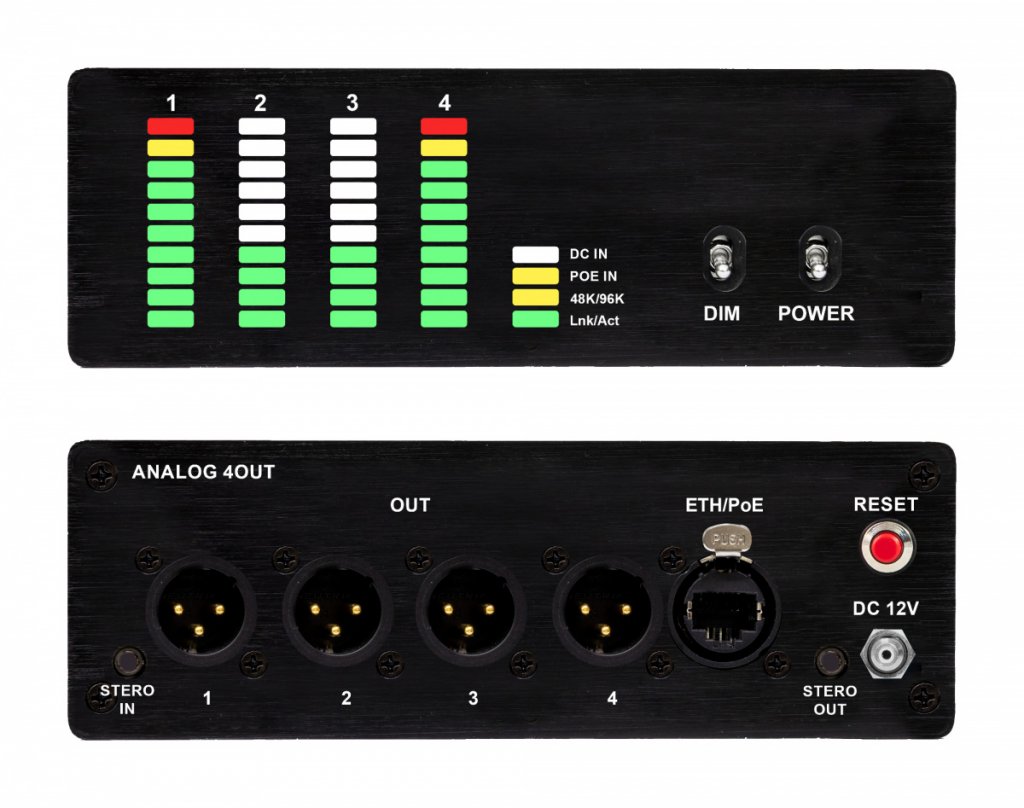

How about considering upgrading to all digital system with AoIP.
Replace the AVP with Nuprime-X H16-AIP (https://nuprime-x.com/product/h16aip/)
You can then send the Dolby Atmos decoded AoIP to computer's Dante Virtual Sound Card and use DSP for processing. You can also send the LFE channel to each sub woofer separately via AoIP to XLR converter.
Keep the HD-AVA for the 2 channel. May be add active speaker for 4.1 setup.
You can buy other brand's AoIP to XLR converter or wait until Jan 2026 for Nuprime-X AoIP to XLR converter.
