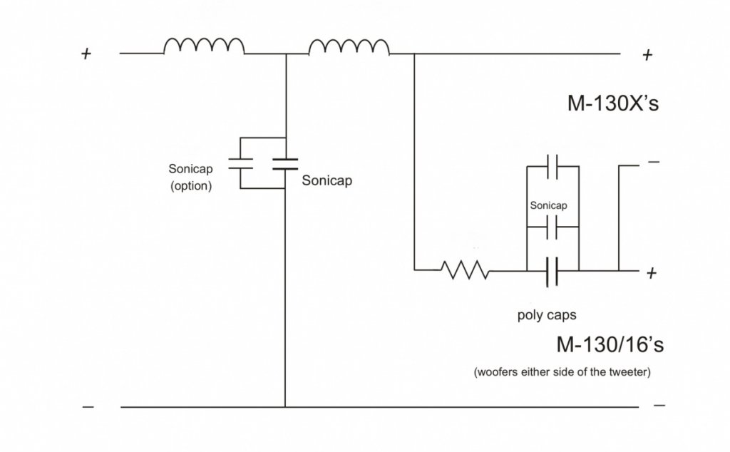

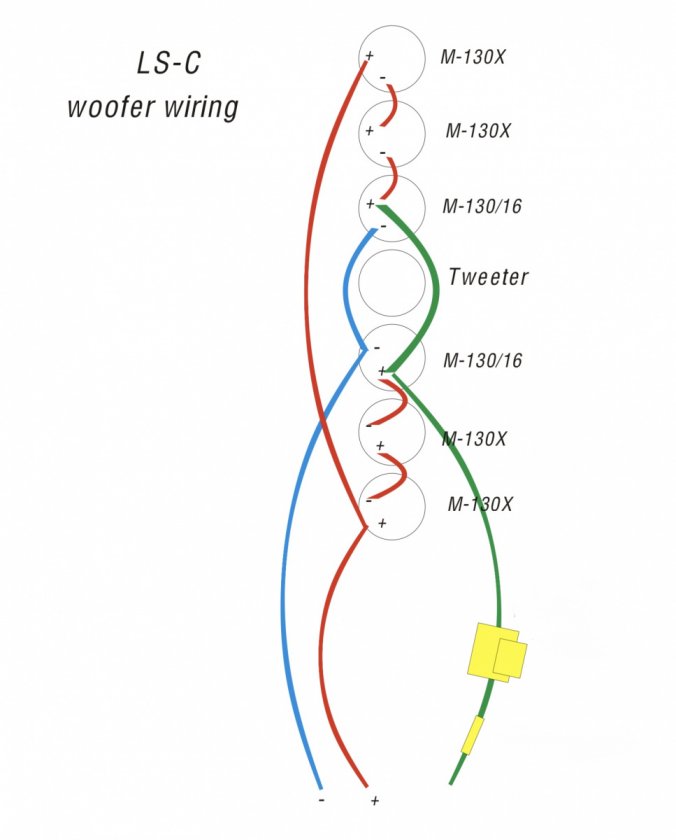

I’m hoping you can help. I’m upgrading my custom LS-C with better inductors and am looking at the diagram you gave me. The XO schematic shows four wires coming off the woofer circuit. The issue is I only see two wires going to woofers according to the speaker wiring diagram. See attached.
Where does the extra pair of woofer wires from the XO go?  Or should there be only 1 pair?

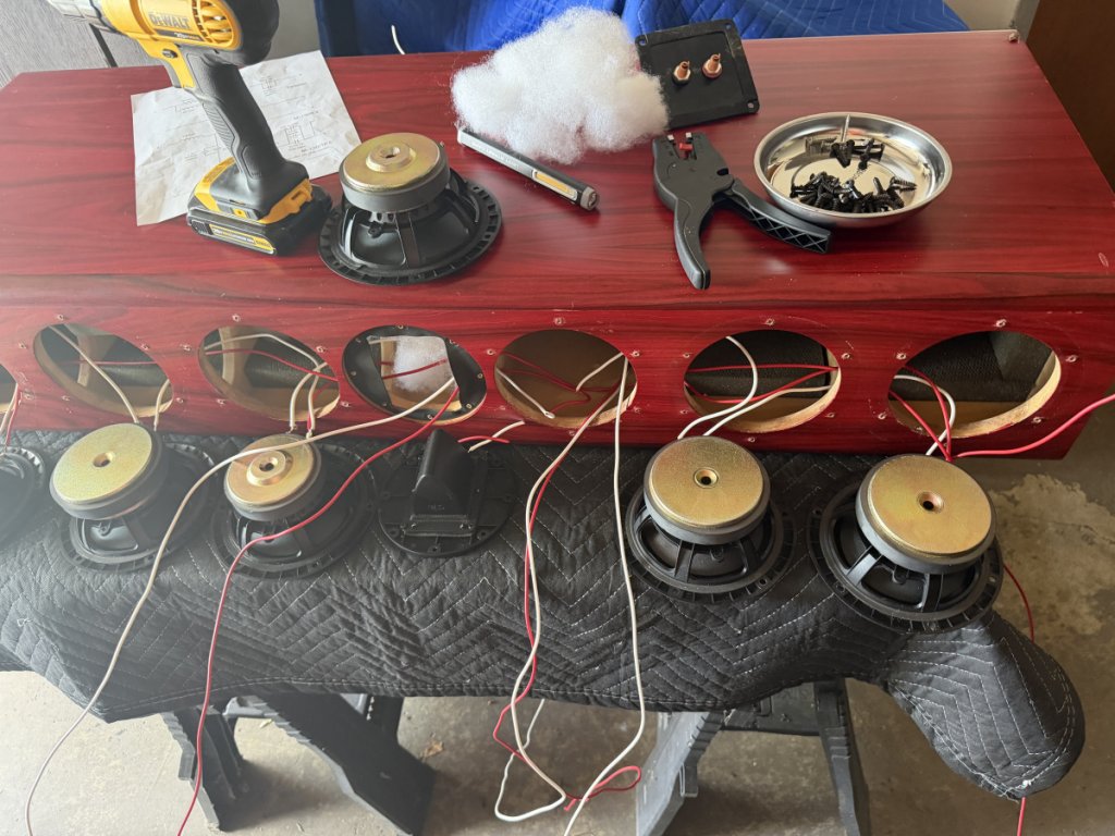

Side note… I also see a cap bundle with a resistor on the speaker wiring diagram but not on the XO schematic?  I have my LS-C taken apart and it doesn’t have this bundle.

Here are the schematics with just the woofer circuit and values removed. Wiring diagram as well.
Danny…let me know if you want this removed.
Robert

Hi Robert,
Sent you text, It makes sense now. I did not see the second drawing.
Frederick
